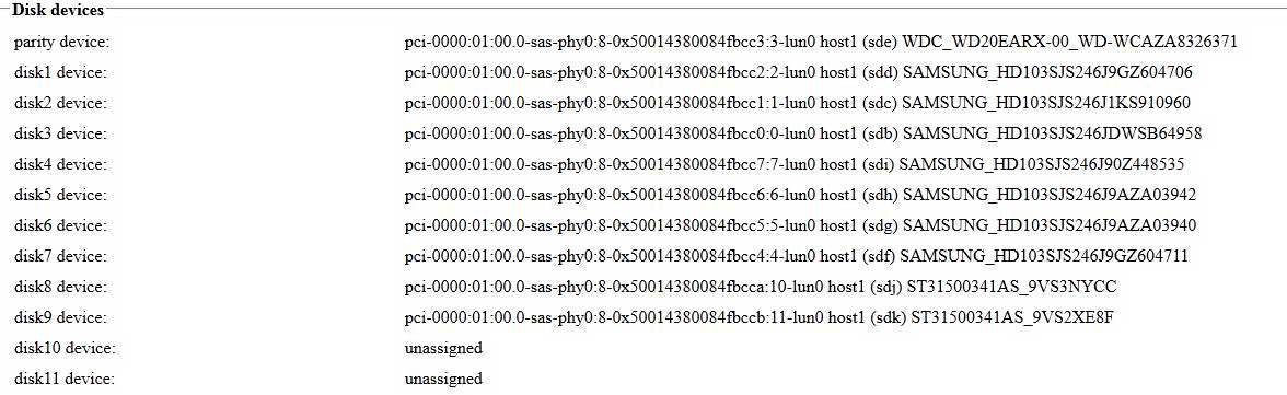

I have 10 disk array unraid server on intel SASUC8I raid controler
I want to upgrade my 4.7 version to 5.0 rc3 because i don't have disk temperature showed on 4.7 version.
But.

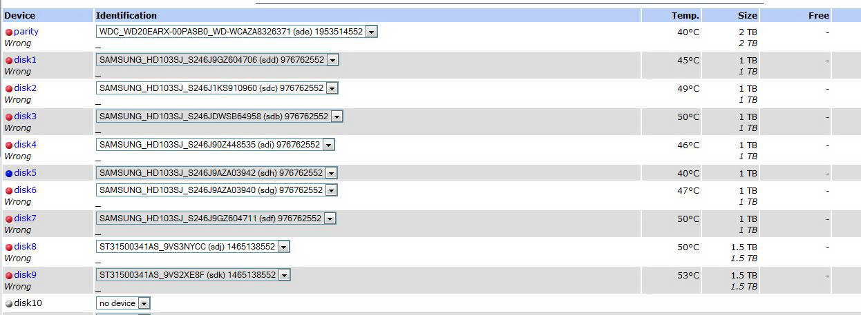

Each time that i try to upgrade (with replacing of bzroot and bzimage on flash drive) 5.0 Version (any beta version) show my disk are Wrong, except one, marked like "new"
I attach this post to screen capture of my disk config. one on 4.7 version. Other on 5.0-Rc3 version.
Any idea to success upgrade ?
Thanks.

It appears to me as if your disk-controller card labels its disks differently under the two versions.  Therefore, existing disks are not recognized.
Easiest solution would be to assign the disks as desired, then to go to the "Utils" link and click on "New Config"
That should then let you start the array, and it will go through the process of initially calculating parity (basically writing parity with exactly what is there now)
before you do anything, make a copy of your existing "config" folder so you can revert to the 4.7 release if desired.

Those temps look very high to me.  You are in an idle state, and the lowest temp is 40, with 3 drives at 50, and one at 53.  I'd hate to see those temps once you start the parity rebuild!  I'd first take a quick look for any fans that have quit.
If you do not want to spend much time now reworking your airflow and cooling, you could take the side panel off, and point a good house fan into it.  It's not very efficient, but I don't think it would do any worse.
Thanks for answers I will try "nex config" solutuion later beacause i have "no parity" enabled because of one disk smart errors. I have a Norco 4U case without sidepanel but high temp are because it seems that idle state do not stop the disks.
I'm not sure what you meant by "without sidepanel" but if you mean you are running without the case closed, then you probably need to close it up. Case fans can't do their job if you have a big gaping hole for the air to go through without being forced over the drive bays. Most cases only cool properly when fully closed.
