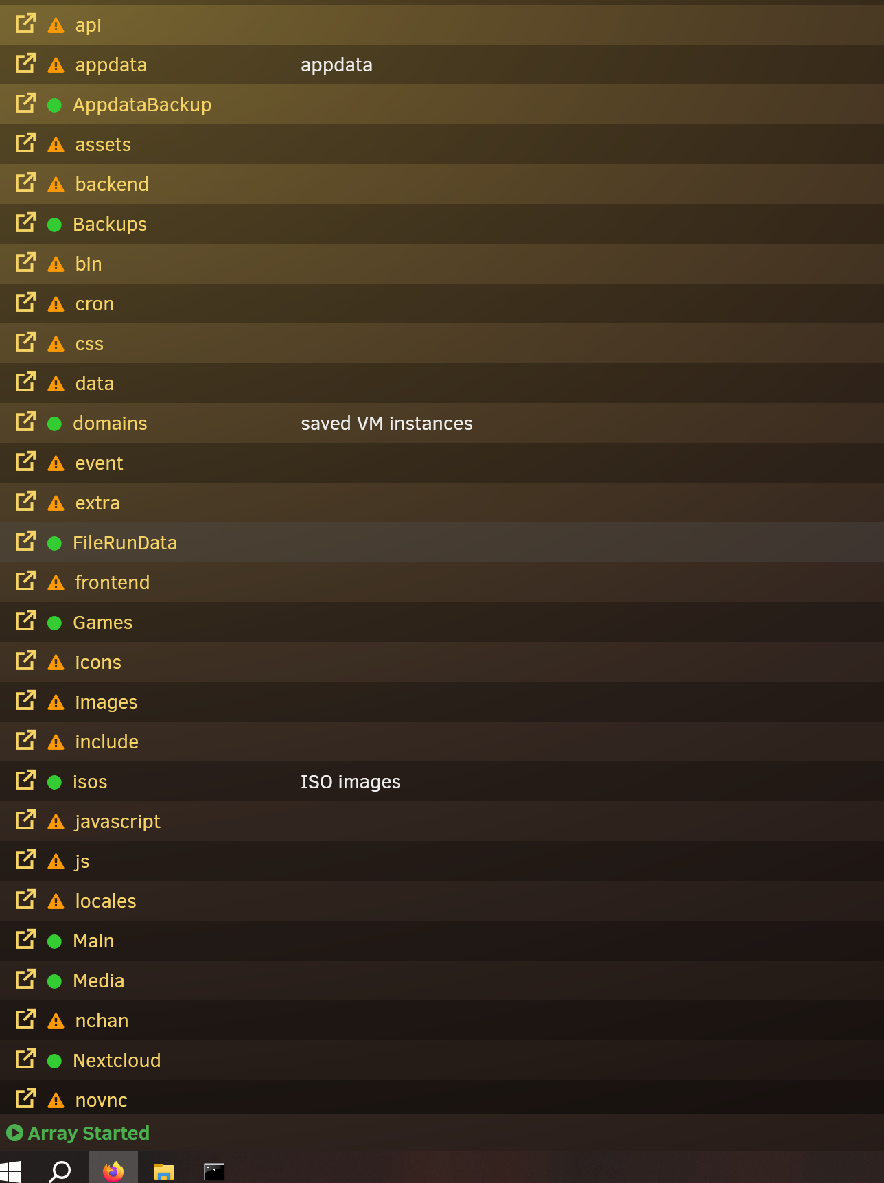

new folders created in /mnt/user/
Hello I am trying to figure out why my /mnt/user folder is now clogged up with what looks to be the os's file system. photo attached. I am on Unraid 6.12.8
any ideas what happened? and how to fix it?tower-diagnostics-20250623-1922.zip

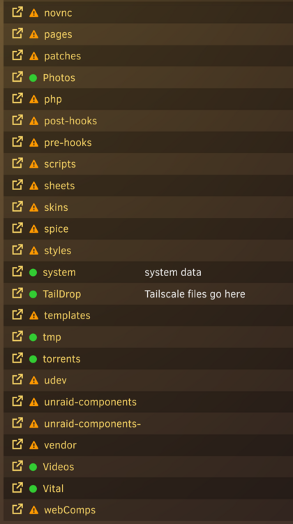

We'll see here is the thing. They are unraid files. I tried deleting them at one point and it made the webgui stop working. Then I rebooted and they showed back up. Idk what docker would be making unraid files. It leads me to think something else is happening.
