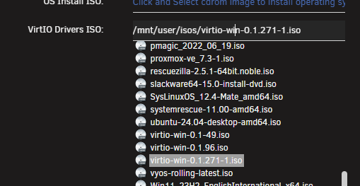

Yes... was the iso selectable from the field as a dropdown? usually should be using the /mnt/user path
Yes, it is selectable. It used to be a different file (which also didn't work). I then upgraded to the latest version. I checked whetehr it can be selected. But unfortunately, none of these tries led to the virtio "disk" showing in Windows Explorer.
I'd try putting the /mnt/user path manually...
Also 221 is old, but that shouldn't affect the "not even appearing"
Edited by Kilrah
I had tried both 221 and 271. And also both mapped to /mnt/cache and mapped to /mnt/user.

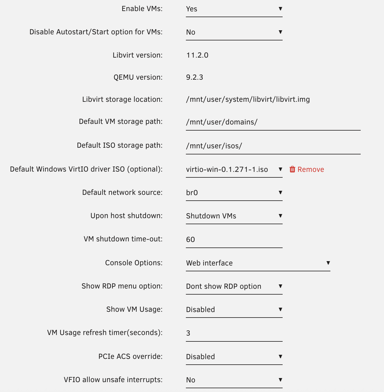

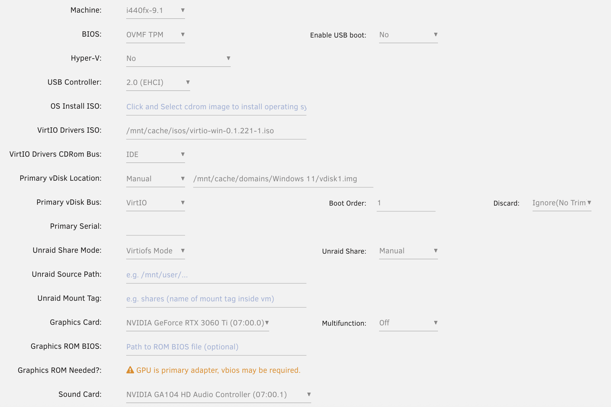

Below screenshot from my VM settings. Maybe something there?
One thing that always confused me is that this Unraid server has a /user and also a /user0 folder. And /addons, /remotes and /rootshare. I do believe that my other Unraid server has none of these?
Could this issue be related?

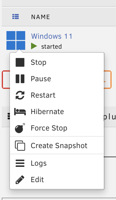

You need to restart the VM, not Unraid, just shutdown won't work.
We are speaking about the same "VM restart"? See screenshot below. I have done this. Both with "restart" as well as "stop /start". Any other ideas?
Yes, that shoudl work

Ah... One idea... Maybe I didn't set it up when I originally set up the VM? If that's the case, is it possible to do so ex-post?

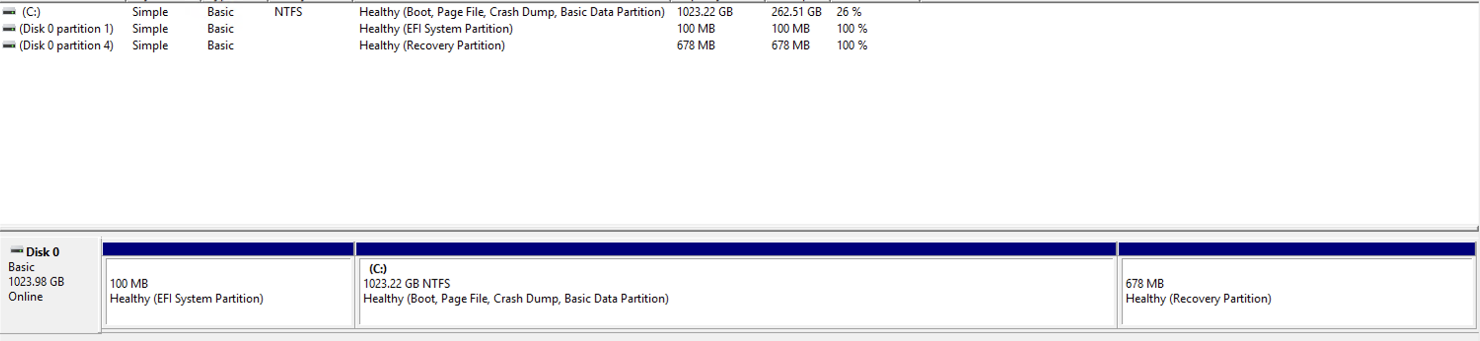

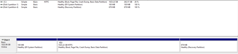

Attached a screenshot from disk management.

Seem someone else has the same issue. See forum post below. I tried the same (change from ide to sata) and indeed worked. However, I now see two D: drives and cannot eject any of them.
