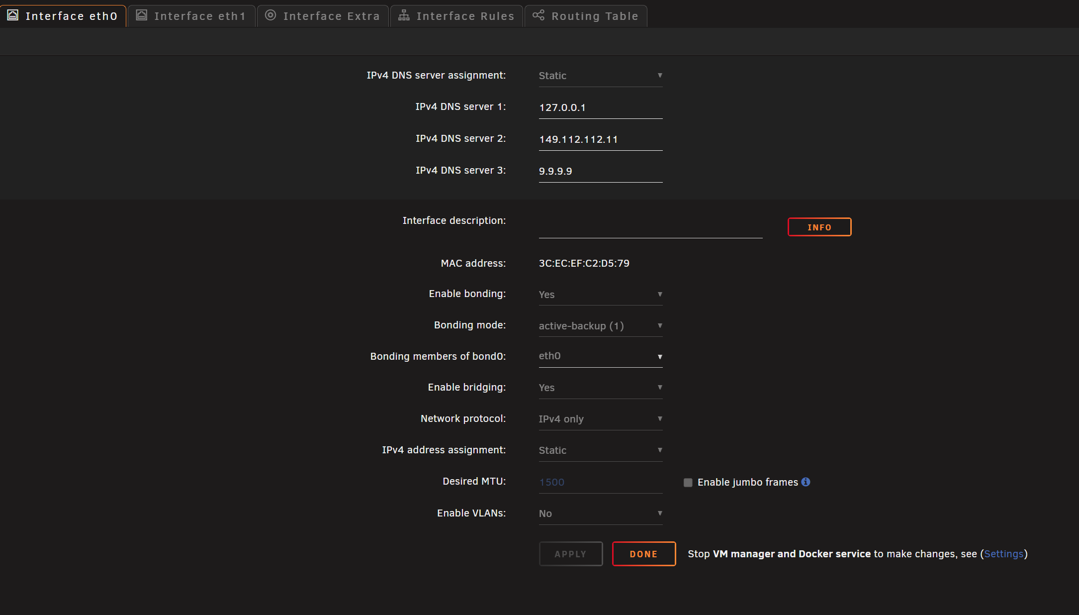

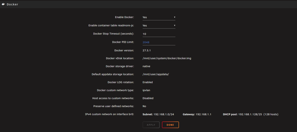

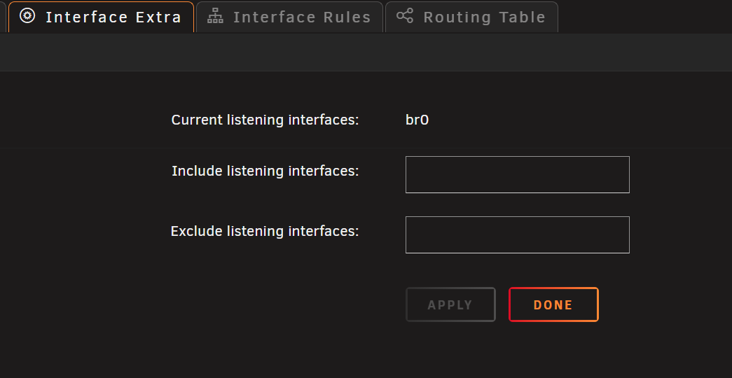

My DNS is apparently BORKED and I don't know how to fix it.
Attached are my network settings and dockers in UNraid as well as my (Tower) network from my router.
I can somewhow get DuckDNS working using -- 1.1.1.1. in advanced in the container under extra parameters and same for SWAG but I keep getting werrors and it will just not work. I tried to connect to google using:

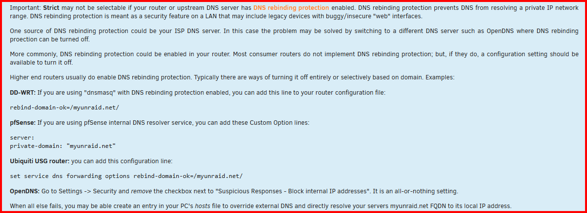

I see you are using a UniFi router. Back a few years ago, I was using a Ubiquiti EdgeRouter X and had DNS problems in setting up the SSL certificate. Here are a couple of posts back from that time:
https://forums.unraid.net/topic/59845-unraid-os-version-640-rc8q-available/page/7/#comment-587753
and
https://forums.unraid.net/topic/61265-what-router-are-you-running/page/3/?tab=comments#comment-637221
The problem is basically explained here:
Hope this might help...

what gave you the idea that unraid runs a dns server on 127.0.0.1 ?
There is none, so nobody will answer any queries.
Delete the entry for DNS1 and move up all others, then it should work.
I changed what you mentioned and all seems to work now. Thank you so much man, I sincerely appreciate it!
As to why it was like that, I honestly don't recall why.
