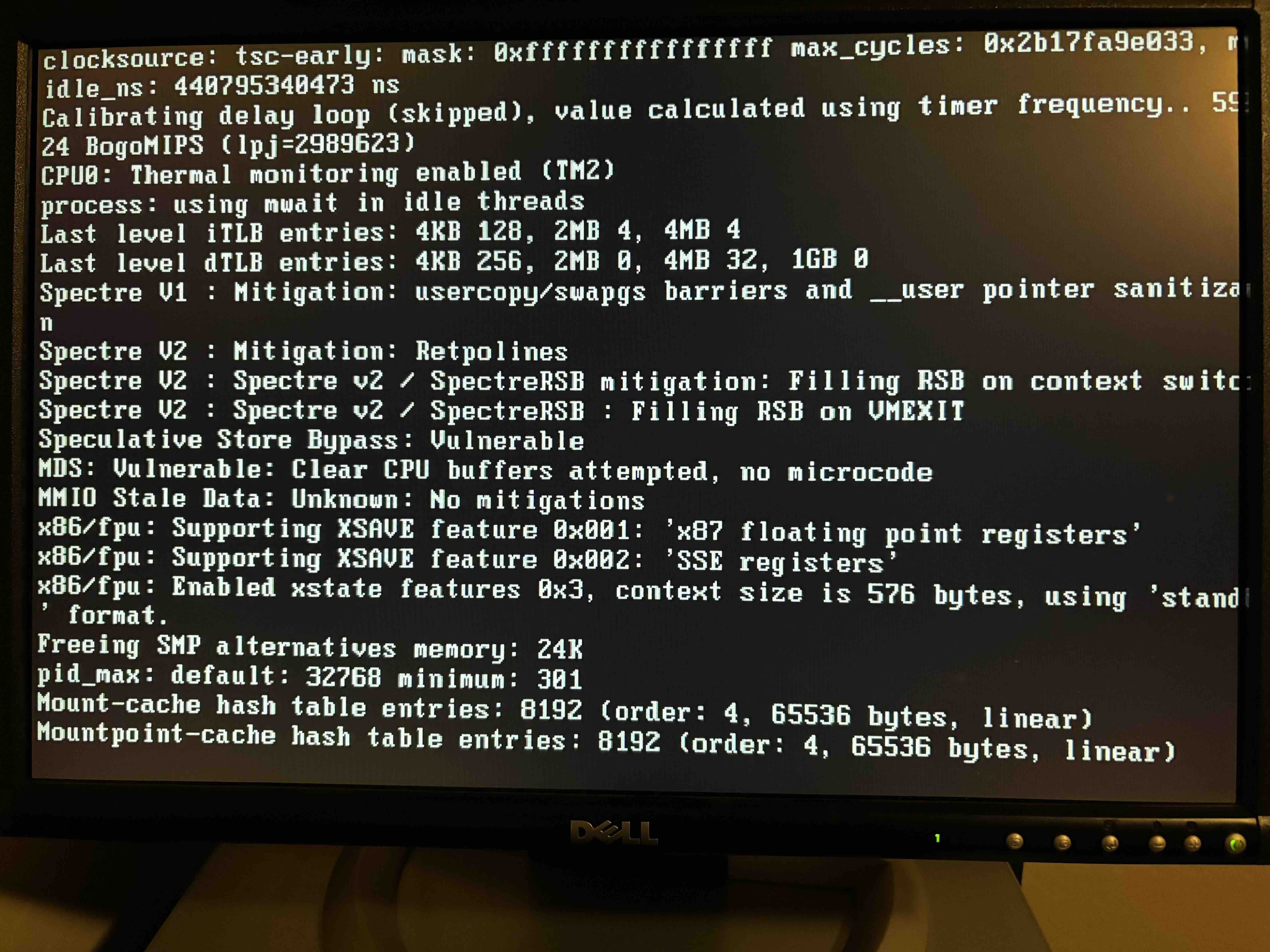

July 15, 2025Jul 15 Every time I shutdown and restart my server, or just reboot, UNRAID does not come back up. During the boot process it always stops at the same place. The link at the bottom of this post is from my original report on this and the solution, at least till the next reboot. It's now happened a total of three times with three different USB drives. The two most recent USB drives are PNY, I'm not sure what the first was. I've tried plugging the drive into different USB ports but this has not helped. This started on version 6.12.14 but also happened on 6.12.15 and 7.1.4. The system always stops at the same place shown in the image below. I need some assistance figuring out what is causing this and how I can fix it for good.https://forums.unraid.net/topic/191531-power-loss-server-will-not-come-back-up/
July 15, 2025Jul 15 Author I've tried this with 7.1.4 and I can reboot one time. On the second reboot, even if nothing is done, it stops at the same place.I've done this twice now and got the same result both times.

July 15, 2025Jul 15 Author Now it stops in the same place even with a freshly built new USB drive (7.1.4)

July 16, 2025Jul 16 Author I tried the trial dive that was not working in my server on two different desktop machines. It worked on both even with multiple reboots. This would seem to indicate that I have a problem with my server, no? I'm guessing either BIOS or motherboard or perhaps RAM / CPU? I know the BIOS is the latest version (if one can call 2012 latest) and it has not been edited in years. Is it possible that the settings just changed on its own? Any good way to track down what the culprit might be, or with the age of the MB (Supermicro C2SEA) would I be best off to just replace it? My concern here is that this very likely means replacing almost everything since the CPU and RAM won't fit in newer MB sockets and even the drive adapters (two Supermicro AOC-SASLP-MV8) may not fit in the slots available on newer MB.
July 17, 2025Jul 17 Community Expert Solution 11 hours ago, pfp said:This would seem to indicate that I have a problem with my server, no?That would be my guess.
