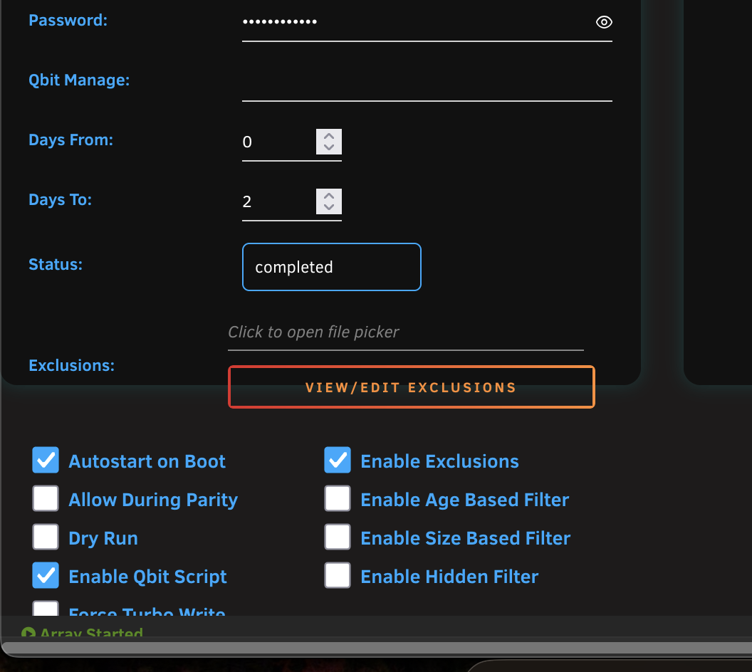

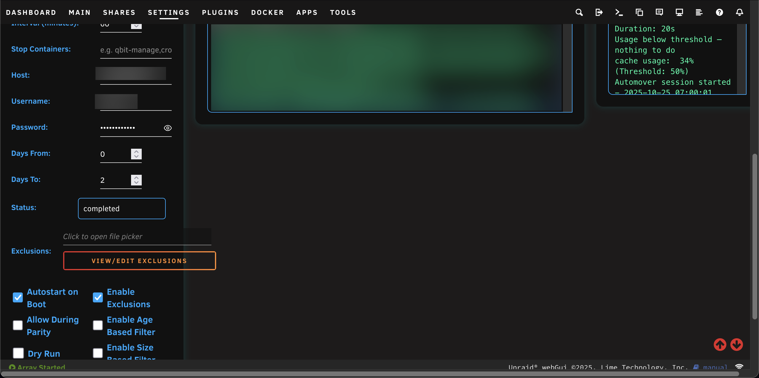

The latest version 2025.10.80 has a bit of broken CSS. When the QBit checkbox is enabled, it causes the checkboxes to overlap the bottom of the container.
What os version are you on?

15 minutes ago, foamy said:
7.1.4
What browser? I just tested with os 7.1.4 with both Firefox and edge on windows and they were fine
I'm using Waterfox 6.6.4 on macOS Tahoe. I get the same behavior in Safari. Note, I'm not on an enormous screen, if that matters, I'm using a 13" Macbook Air. The browser width is ~1265px. I only know this because it trips a separate bug where there is a horizontal scroll bar due to a bad CSS default for the whole web UI. I'm hoping Unraid 7.2 fixes that.
I believe the issue is that the rectangle the content intends to live in is set to a fixed height, so it doesn't flex when child content wants it to be taller. It probably shouldn't be based on viewport height if the intent is to use it as a wrapper for variable height content that can be taller than the viewport. In DevTools, if I disable the height and max-height CSS in the class below, it renders properly both with and without the Qbit checkbox enabled

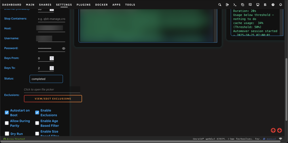

#automover-settings {
  flex: 1;
  height: 105vh; /* can probably remove this */max-width: 450px; /* this may not be a good idea for variable width screens */max-height: 105vh; /* can probably remove this */
good catch, that section was meant to be deleted, it's a duplicate to what is at the top. on the next update it'll be removed

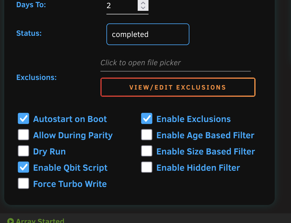

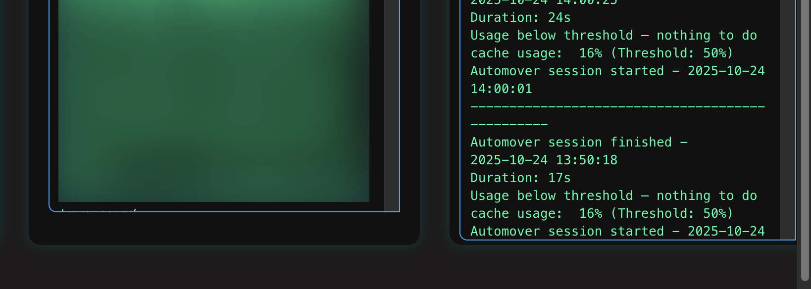

Another CSS tweak would be making these consistent, since both are logging containers. Right nmow, they use different margins for the text containers I'd even go further to suggest stacking them, with the run history on top and made less tall, to allow for the file migration log/history to be wider. That current layout is hard to use since it wraps so much of the content. I only see like 5-8 file migration log lines due to the current wrapping.
2025.10.81.4 update hopefully helps with the smaller screens

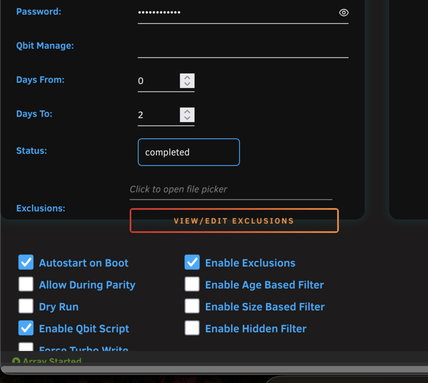

Vertical is good, but now the first column spills over horizontally. Yeah, I know, CSS sucks. I hate it as much as you do. :)
Edited by foamy
yes i suspected some of them would still be off, glad to hear the vertical is good. will work on the others over time but can't guarantee anything
i released a new update with some more css changes, hopefully it helps
