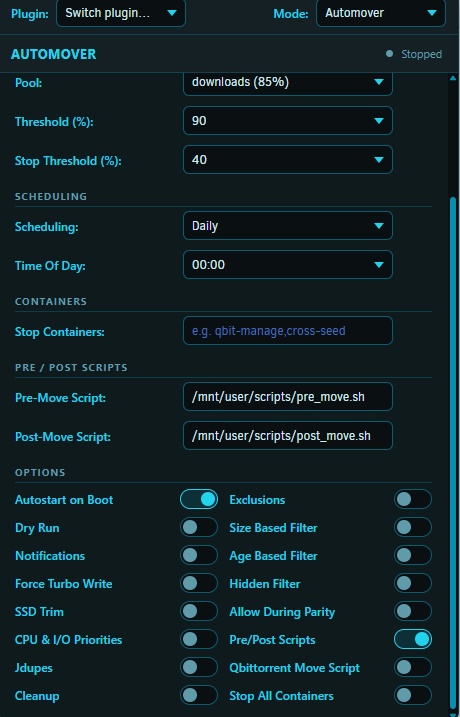

when i enable pre/post script and save. it does not save, when i reload its empty. it will not save my pre/post scripts?
sorry about that, fixed in new release

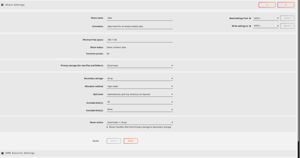

question i have my downloads and media on a ssd downloads pool. can automover move my files from that ssd to the array? Session finished - 2026-03-10 04:04:44

yes it can, my guess is you just installed and tried using the move now button? if so other users are reporting the bug the move now button doesn't work until the first scheduled run runs

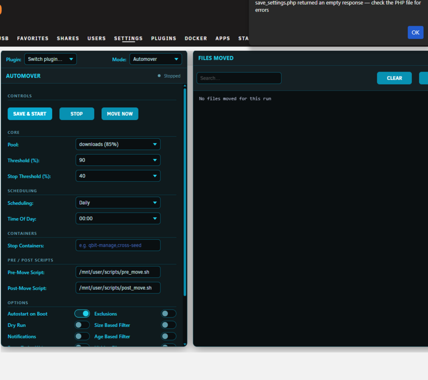

@jcofer555 I keep getting this error when i try to save: save_settings.php returned an empty response — check the PHP file for errors
what version of the plugin are you on? and can you send a screenshot of the settings you have selected when clicking move
Im on version 2026.03.16.03 and my settings im trying to save: image.pngimage.png

is there an update on the "save_settings.php returned an empty response — check the PHP file for errors"
should be fixed in next update hopefully. should be sometime today that i push the update
