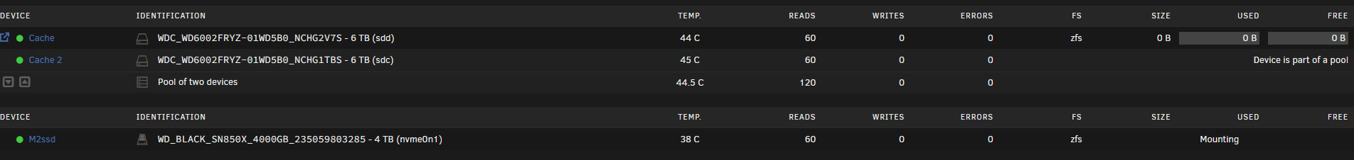

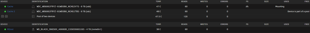

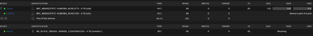

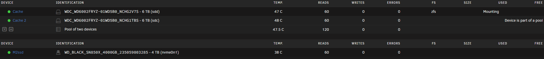

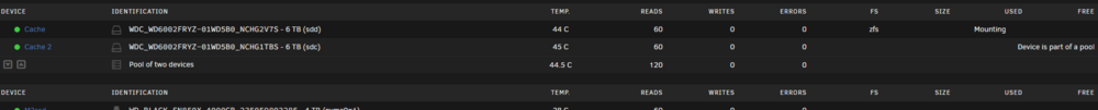

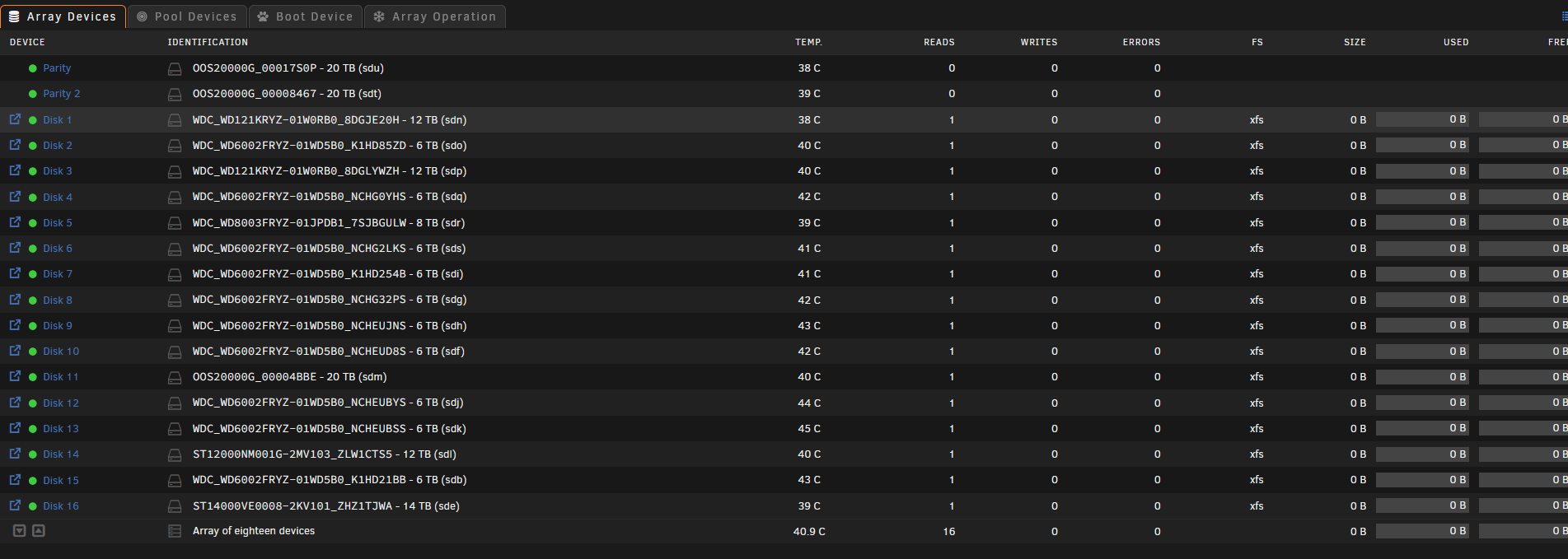

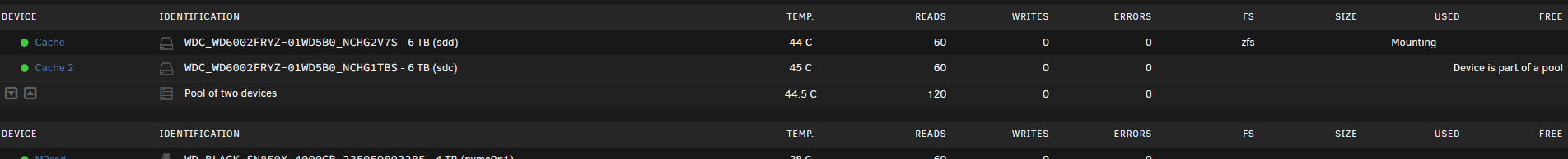

  4. Unraid Version - 6.12.13 After a reboot, it takes about 17 mins before all drives mount. It seems like the data drives (16+2 parity) are mounted but the ZFS Pool devices are taking a long time to mount. I have attached diagnostics and safe mode diagnostics. Please let me know if you need additional information. Safe Mode: Chose "Start" to start the array around the 2 min uptime mark 16+2 Parity at the 2 min uptime mark ZFS Pools at the 2 min mark: 13 min uptime All devices mounted and started displaying used/free space at the 16 min uptime. billstower-diagnostics-20240829-1619.zip billstower-SAFEMODE-diagnostics-20240829-1711.zip
