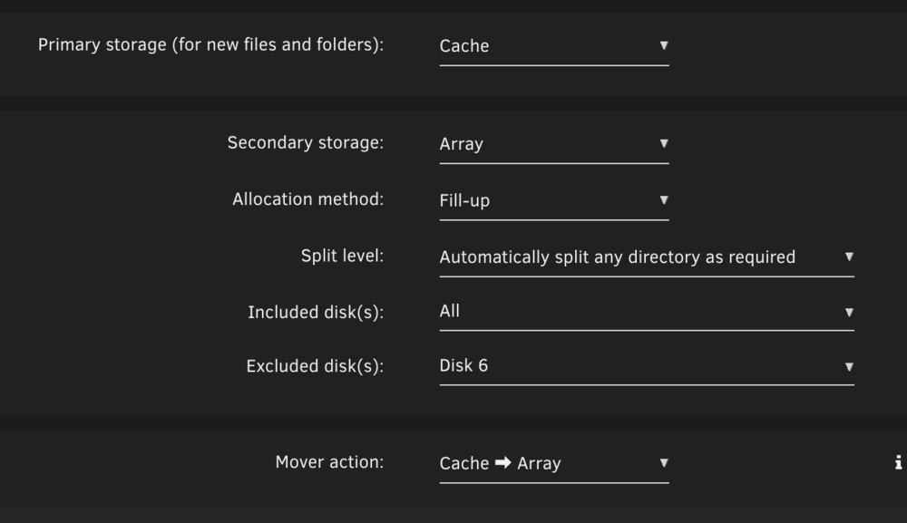

you don't have the share setup correctly to use mover, you need to have primary storage set as cache, secondary storage set as array and mover direction cache -> array. mover tuning being uninstalled will reverse whatever was tuned, best to reboot unraid after removing it though

It is set up that way, and that never changed. Unless the mover binary is supposed to be 0 bytes, that's my issue. Something in this setup/t-shoot 0'd that, otherwise.

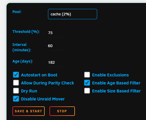

I checked the "Disable Unraid Mover" box, but the normal mover keeps moving the files into the array, even though the cache fill level hasn't been reached, nor are the files old enough.
I've had the mover write the files back to the cache several times, but during the nightly run, it pushes them back even though Automover is enabled.
the removal of unraid mover has been removed from this plugin due to the complexities of how it needs to be implemented
