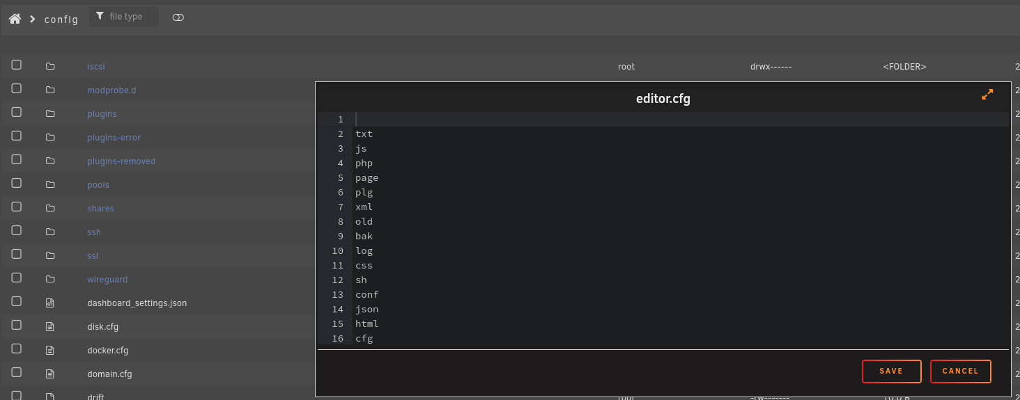

August 10, 2025Aug 10 Community Expert 23 hours ago, timg11 said:I am trying to access the appdata share over SMBYeah unfortunately the appdata folders for each docker container will likely prevent an unraid "user" (except root) from altering the contents. Obviously you cannot use "root" as an SMB user so you'll have to use the unraid webGUI and built in dyanmix file manager to configure files.You can add additional file extensions by editing the /boot/config/editor.cfg file on the flash drive

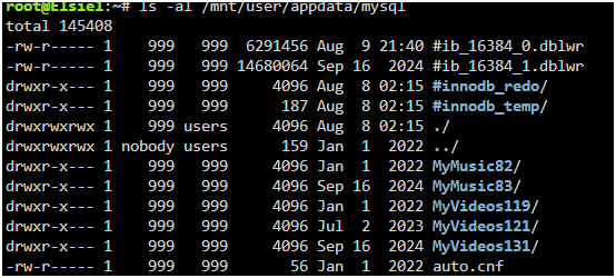

August 10, 2025Aug 10 Community Expert On 8/9/2025 at 11:36 AM, timg11 said:What could prevent the SMB security/permissions from being applied as configured?Start by reading this post: https://forums.unraid.net/topic/191221-some-musings-on-smb-and-samba-and-unraid-and-windows/#findComment-1561580Notice the snippet of the permissions in the example. They area read-write for 'owner', 'group' and 'other'. Notice the group for all of the files is 'users'. Now run this command in a WebDUI terminal:ls -al /mnt/user/appdataNow drill down to the file(s) where you had the problem and look at the Linux permissions for 'group' and 'other' as well at the name of the 'group'. This will show why you don't have access via SMB which itself is restricted by the permissions/owner/group setting of Linux. (Samba is an application program in Linux and not a part of the operating system. It uses Linux file system calls to files to access them just like a word processor would. As such, The Linux file permissions are enforced!) As an example, have a look at this snippet of the mysql Docker:
