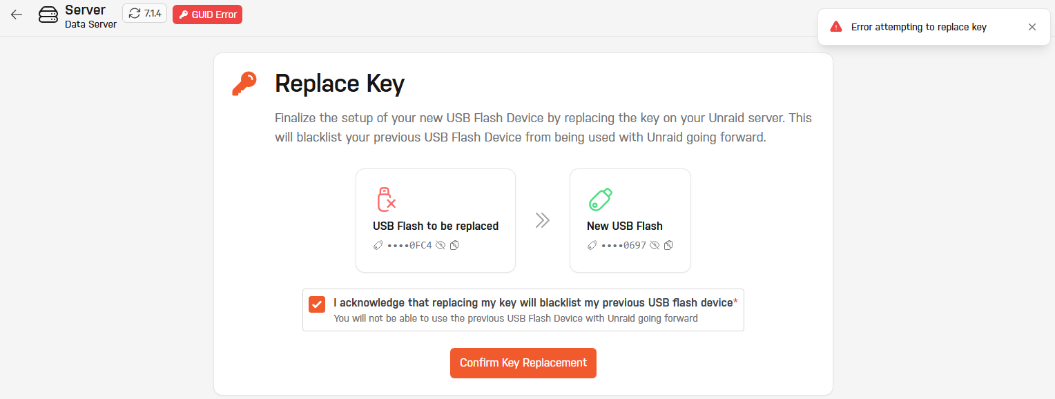

Copied everything over to new USB and trying replace but get replace key failed message

Seem to be having an issue with replacing key so have submitted a ticket this time #15625
