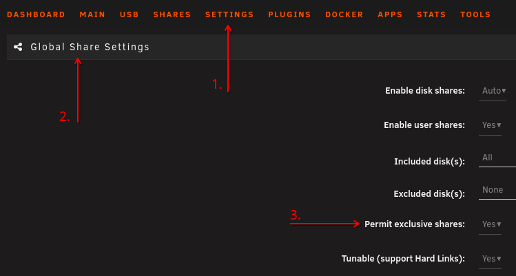

August 18, 2025Aug 18 Community Expert Simply set secondary storage to "None" and continue to use /mnt/user/appdatafor best setup (you can also use /mnt/cache/appdata but there is no need to.)You 100% do not want to move appdata to the array. (which you have configured do to so, this needs fixed)It is also recommended to enable exclusive shares for a performance boost:click settingsclick global share settingsset permit exclusive share: yes Edited August 18, 2025Aug 18 by MowMdown
August 18, 2025Aug 18 Author OK so i did this for changes and permit exclusive sharesShould i change the docker /mnt/cache/system/docker.img back to /mnt/user/system/docker.imgEdit: updated images Edited August 21, 2025Aug 21 by sekrits
