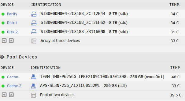

August 24, 20251 yr In 2021, I bought a new system for Unraid. For the cache, I used a 256GB M.2 SSD and another 256GB SSD. I believe I bought a Teamgroup MP33 M.2 PCIe SSD, and I put a heat sink on it.It, unfortunately, is always hot. It's at 46C right now, while the other SSD is 33C and the drives are 31-34C. This causes alarms and intermittent fan spikes. The info for the motherboard lists this: M.2 Socket (M2_1) (Type 2230/2242/2260/2280)*Can anyone recommend a replacement that isn't as hot? And should I put a heat sink on it?Thank you.

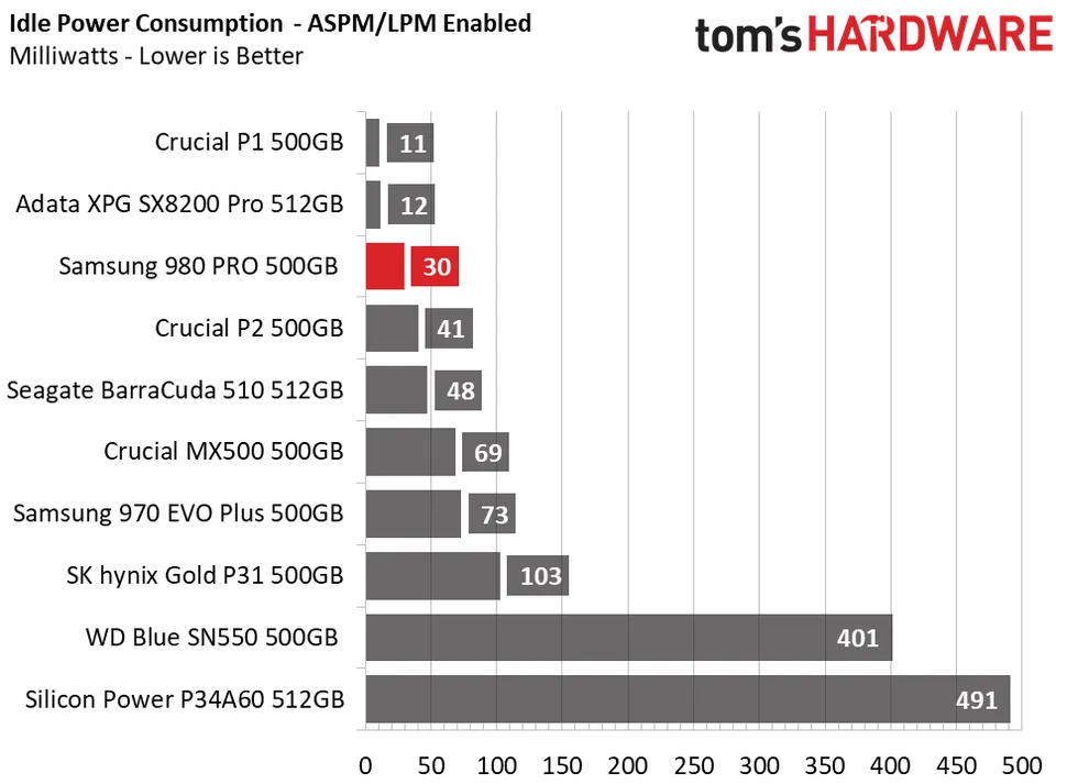

August 24, 20251 yr I have very good experience with Samsung 980 Pro 2TB (or 1TB) with enabled ASPM it has very low idle power consumption and it produces no heat (or very low heat).But I have also one newer model 990 Pro in my desktop and it is +10°CBoth are cooled passive in fanelss desktop PCsee: https://www.tomshardware.com/reviews/samsung-980-pro-m-2-nvme-ssd-review/2#power-consumption-and-temperaturethis is more comprehensive:https://www.techpowerup.com/review/samsung-990-pro-2-tb/7.htmlfind 980 Pro there: 👇 Edited August 24, 20251 yr by bagican
August 24, 20251 yr 46C is not really hot for an SSD, and note that you can set specific thresholds for each device.
August 24, 20251 yr Author Thank you both. Well, I have another system using Kodi where the motherboard is going bad. I thought since I have to buy all that (motherboard, M.2 storage, processor...), I should consider fixing this issue, if it is one.Huh...I do see I can set a warning and critical threshold. I did not know I could do that. What is a high temperature for an SSD? And, whoa, when I bought 256GB 4+ years ago, I thought that was big and costly. Now, 1TB versions really aren't that expensive.

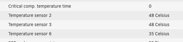

August 24, 20251 yr Also, are you sure that it is actually that hot? For it may not be reporting the correct temperature.I have a Leven JPR700 NVMe in my server that reports it is 48C all of the time, regardless of how much it is being accessed. There are 2 SSD drives that are almost always around 21-27C, and the spinning HDD mainly sit in the low 30C. The Leven has a nice heat sink on it, which was used for years on other drives successfully.Looking at the drive's Attributes tab in Unraid, I have 3 sensors reported. When I stress the drive only the last one, which sits at a more expected 35C, rises in temp in a normally expected behavior.

August 25, 20251 yr Author I don't know that it's that hot. This is what I get:I bought a "fancy" motherboard that allowed me to remote into it...until the password got corrupted somehow. If I could remote into it, I could access the temperature. I have figured out how to correct this, but I need to make a bootable USB, shut everything down, boot, change the password, etc. I haven't had time to do that.I did buy a heat sink for this and put it on when I installed it. Can't remember what I bought though. The system is in the basement, which is generally cool. It's right by my workout "room", and yesterday in the morning when I was working out, the fan was coming on, going off, coming on, going off....I'll adjust the temperature and see if that helps. I also have to change out a hard drive, so I'll look into this again this weekend when I do that.
