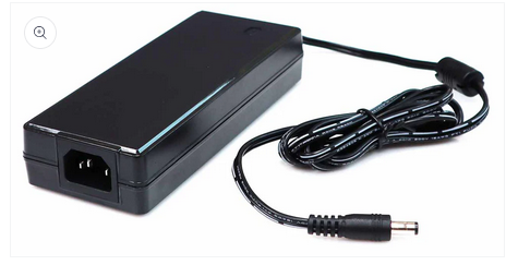

what kind of power supply unit (wattage?) are you using to power the disks?
Im using the recommended power supply for 4 hdds from hardkernel. 19v 7a 133w
I wonder if that is enough. Do you have any way to test with a higher capacity PSU. The fact that adding the 4th drive makes it start crashing does suggest it could be power related.
I dont think thats the issue as I already reached over 97%. At this stage 2 of the 4 drives already finished and spin down. But I also dont have a second psu.
One test you could try to confirm this if you do not have another PSU to try is to remove (for the time being) one of the data drives and see if you can then complete the parity check. I have found if a PSU is borderline to exceeding its capacity then you can get unpredictable crashes.

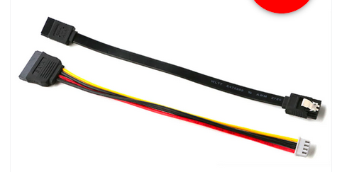

But like how are the actual HDDs connected to the power?
This is the PSU for the Odroid but what about the HDDs?
Are you using these?
Edited by MowMdown
Yes I use these cables, the HDDs are directly connected to the motherboard
I see nothing in the Odroid H4+ documentation on the hardkernel site that suggests that 3.5" HDD can be powered directly from the Odroid board. I would expect each HDD to have its own power supply, and then just have a SATA connection to the Odroid board.
I ordered the Odroid with a type 4 case which is designed for 4x 3,5 Hdds in the way I use it. Anyways I already reached 97% of parity and at this state 2 of the 4 drives already finished without problems.
