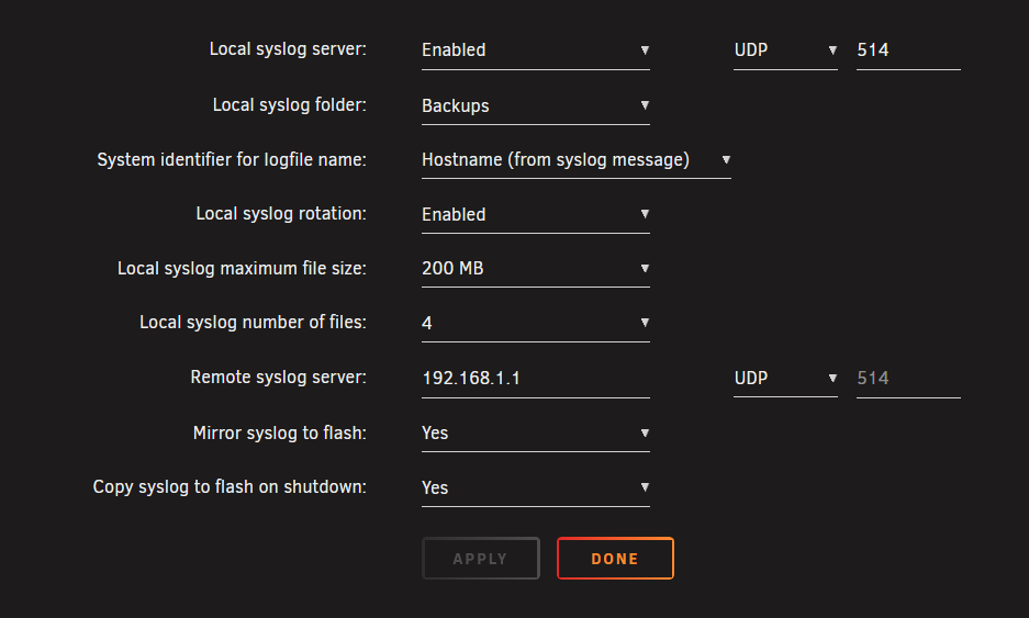

I have that enabled and I also have write log to usb enabled, sorry I thought it was included in diagnostics.

Are you sure you have the syslog server configured to actually write something rather than just listen?
To get something written you need either mirror to flash option which is the easiest to set up (and if used the file is then automatically included in any diagnostics), but if you are worried about excessive wear on the flash drive you can put your server's address into the remote server field and log to a share instead.
yeah I have done both
