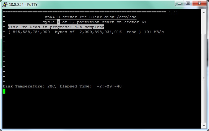

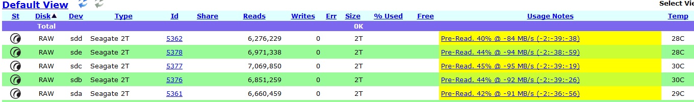

Anyone seen negative numbers on MB/s when preclearing drives?  Started out just fine then 20% in I refreshed and it started showing negative numbers.  I precleared a 2tb last night and all was fine but I was running 5.014b, today I upgraded to rc3 and started preclearing these 5 new ones and this happened, no array set up just these new drives.  Telnet screen shows correct positive numbers but unraid web shows negative.
ok I take that back, telnet does show correct positive MB/s but the estimated time is still negative numbers.

nope, kicked it off and let it run.  I just went back and hit refresh to see where it was at.
I can see your logic and agree with you that a time adjustment of some sort could have happened behind the scenes but the MB/s isn't time related so why would it be negative.  I refreshed this morning and everything was back to normal.  I can't explain it, just wondered if anyone else had experienced it and if it was a bug....and if it was a bug where is it, unmenu or unraid or something else.
