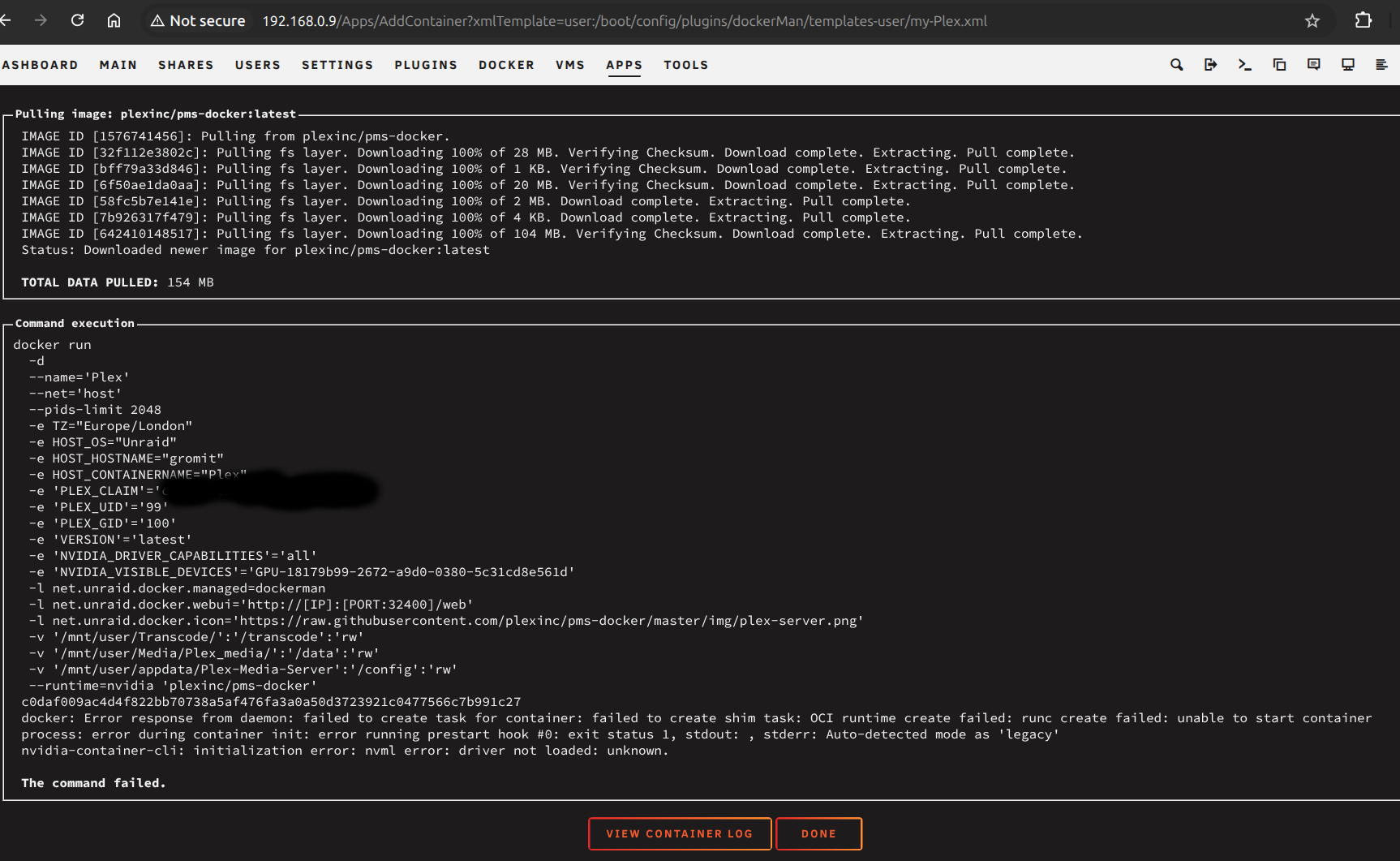

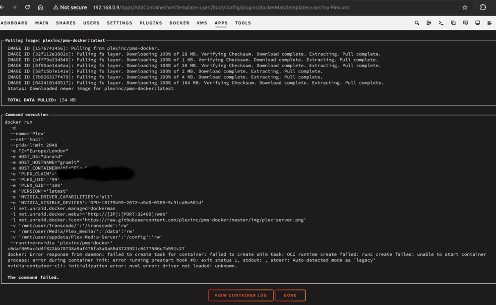

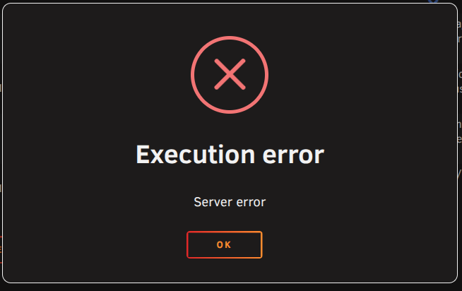

September 3, 20251 yr Hi, I've just upgraded from 6.12.15 (or possibly 6.12.14) to 7.1.4 all seemed ok except Plex aint working. The few other Docker containers i've got started ok and are running, i get this when trying to start the Plex container:I removed the container and re-added via the previous apps tab, and get "The command failed" 😭I backed up the USB before the upgrade so I should be able to roll back, but if anyone could help sort this out it would be very much appreciated.Paul. gromit-diagnostics-20250903-2033.zip
September 5, 2025Sep 5 Solution Look like its something related to the nvidia driver. I'd try uninstalling the nvidia plugin and reinstalling. If it still fails, ask in the nvidia plugin support thread
October 24, 2025Oct 24 Author Thanks. Yes. was an nvidia driver issue. I got Plex back up and running pretty quickly by removing the NVIDIA_DRIVER_CAPABILITIES and NVIDIA_VISIBLE_DEVICES variables, and the --runtime=nvidia extra parameter (need to click on advanced view).This got Plex back in action (but without a GPU) and i've only just now had chance to try to figure out why it stopped working.Turned out to be that the card is just too old now. Logs say "The NVIDIA GeForce GT 710 GPU installed in this system is supported through the NVIDIA 470.xx Legacy drivers." .When i looked into getting these installed they aren't in the nvidia plugin anymore, as confirmed here by @ich777 all was fine when i was on Unraid 6.12.15 but no more. nevermind. That card was just junk i had lying around anyway, so no big deal.
