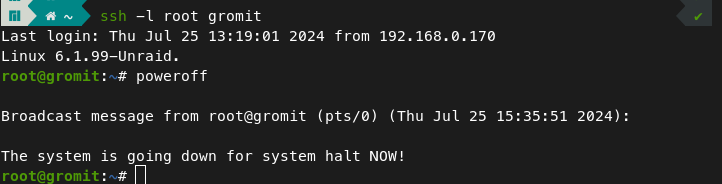

  8. I just shut it down via ssh: It went off on it's own (without me having to hold down the power button). I've switched it back on and extracted more diagnostics, attached.
  9. Good afternoon, Whenever I try to shutdown or reboot the server, it always hangs partway through the process. I always end up having to hold the power button on the front of the machine to finish the shutdown (after waiting 10 mins or so). Interestingly, it doesn't seem to have this issue when using the poweroff or reboot command when SSHing in, or using the console on the web GUI. I try not to go this route though as I'm unsure if this is a good idea or not. Any help in troubleshooting this would be appreciated. I've not really any idea what to look for in the logs. thanks, Paul. gromit-diagnostics-20240725-1314.zip
