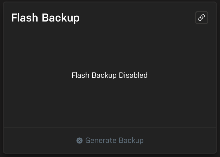

Same here, in unraid connect online it even says that it is deactivated:

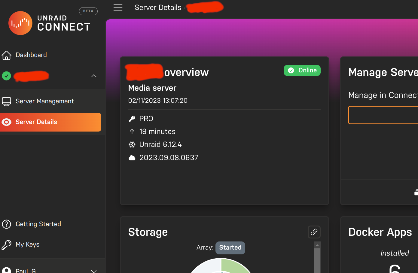

It's a fairly new server, so I didn't have remote access allowed until today. I've enabled that (Dynamic - UPnP) and it connects ok:

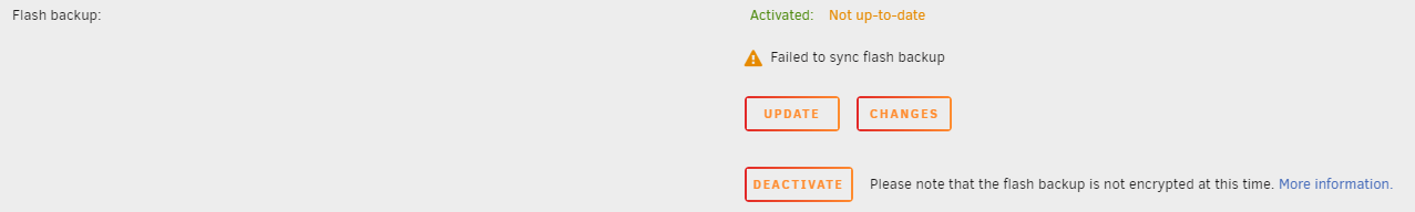

In the Flash backup settings on the management access settings page, Flash backup is activated:

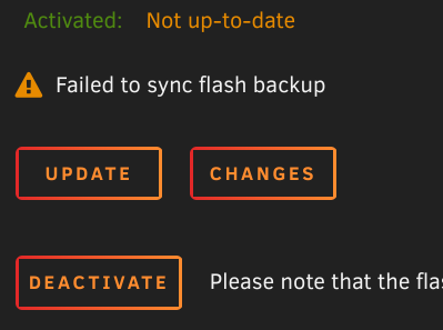

Not sure what's going on. I can't get any further than this. just keep getting "Failed to sync flash backup", and on the Unraid Connect page, the Flash backup page incorrectly says that I haven't got Flash backup activated:
I tried deactivating Flash backup and activating it again, which didn't help. I then checked the forum and found this thread at the very top, so am guessing there's an issue somewhere!!
