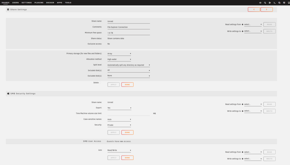

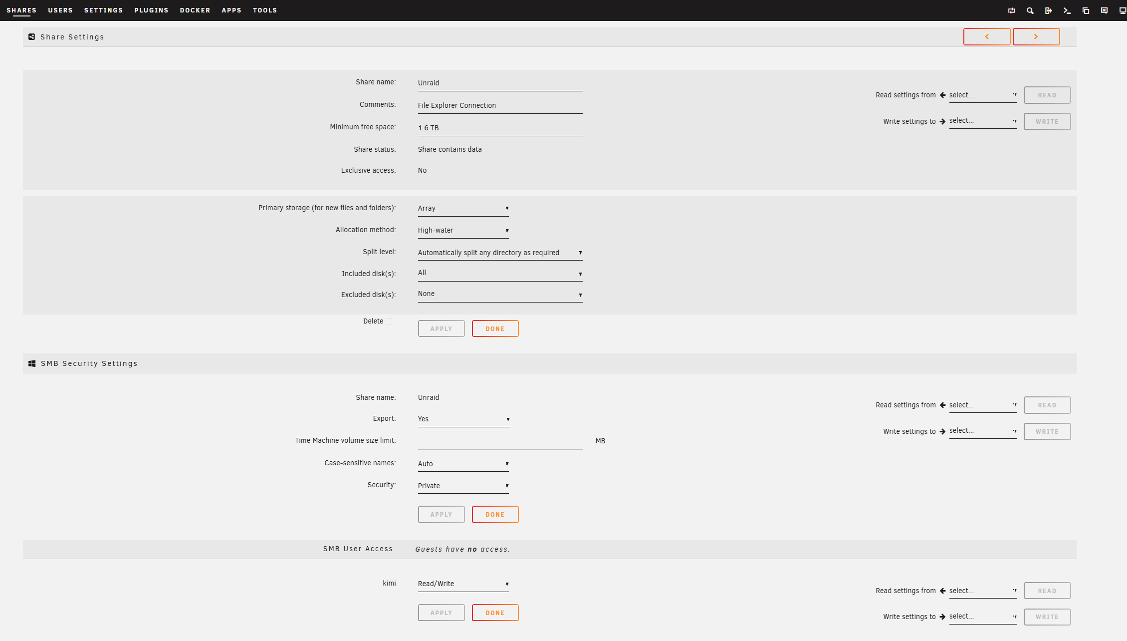

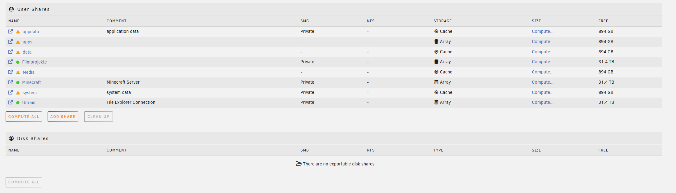

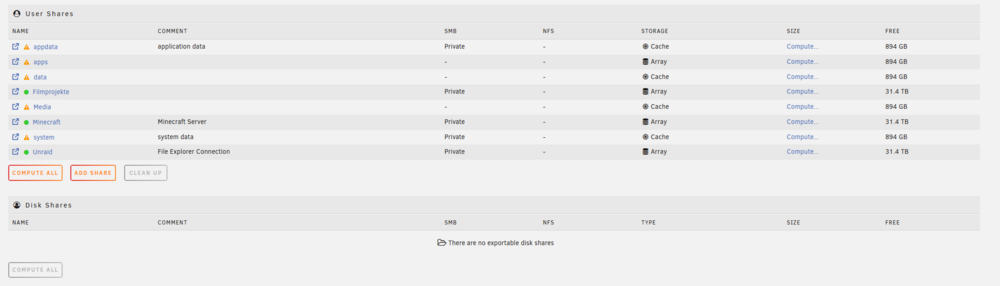

I assume you mean you cannot access the shares over SMB? If yes, post a screenshot from the Shares page.
No, the Server isn't even showing up in the file explorer. I had saved the shares and the "TOWER" generally in the left-hand bar, but I can't access it through that and in the "network" section, it's not showing up anymore.
