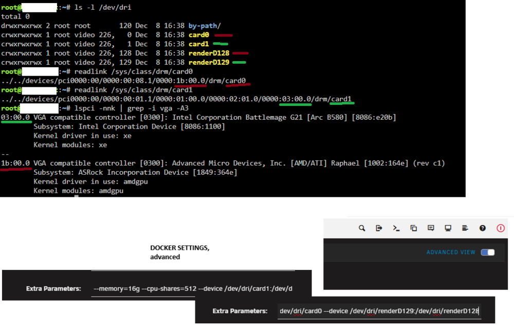

Trick is to pass "--device /dev/dri/card1:/dev/dri/card0 --device /dev/dri/renderD129:/dev/dri/renderD128" to all your dockers that you want to use in 'extra parameters'.
I found other tips to use "--device=/dev/dri", but this passes through both GPU's, and I really only want the actual discrete card passing through so I can use the igpu for a VM or something later.
BUT FIRST you have to make sure that card0 and renderD128 are the right ones. I have my igpu enabled and that takes up card1/D129 on my system.

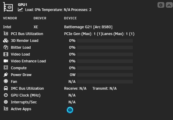

Steps: Get plugins "Intel GPU TOP", "NVTOP" (I use this for the top in CLI, you may not need?), "GPU Statistics" (this one is bugged until the kernel updates and supports ARC and then Unraid adopts that, but at least its a quick check to see if it even recognizes my card)
In unraid CLI, use these commands:
ls -l /dev/dri This should print out your card0, card1, and renderD128/D129 and whatever else.
readlink /sys/class/drm/card0 This will print out some stuff, what you want is right before /drm/card0
readlink /sys/class/drm/card1 This will print out some stuff, what you want is right before /drm/card1
lspci -nnk | grep -i vga -A3 This will let you match your actual video card to your card1/renderD129 or whathaveyou, for the above "--device /dev/dri/card1:/dev/dri/card0 --device /dev/dri/renderD129:/dev/dri/renderD128"
Now, in my case I want to use card1 which is my B580, and not card0 which is my igpu. What this actually means, I have no clue. Actually, scratch that (just asked AI, editing post). You want card0 and D128 to be on the RIGHT side of the above command, whatever your left sides are. Just so happened that mine were this way. Ask AI why, it can explain somewhat easily.

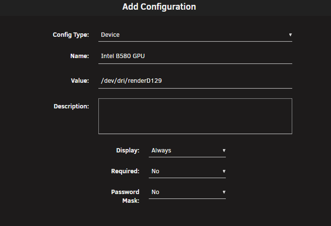

Pic example:
I do the extra CPU resources and RAM settings for each docker, doesnt matter for this guide.

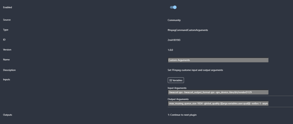

In the custom arguments section of Tdarr, i had to do some inputs and outputs on suggestions with AI. I did some extra stuff but that wouldnt work without running the docker in privleged mode, which I didnt want to do past testing.
Here is how I got the B580 working without having a privileged docker:

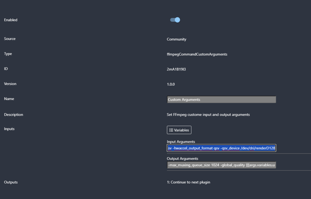

Input: -hwaccel qsv -hwaccel_output_format qsv -qsv_device /dev/dri/renderD129
Output: -max_muxing_queue_size 1024 -global_quality {{{args.variables.user.qual}}} -extbrc 1 -async_depth 4 -look_ahead 1 -look_ahead_depth 30 -extra_hw_frames 30 -b_strategy 1 -adaptive_i 1 -adaptive_b 1
Some of that output above is needed, some isnt. I don't know which is required due to the B580 and what is needed per the flow instructions. The RenderD129 part is again, because 128 is my AMD igpu, 129 is the Intel Arc GPU.

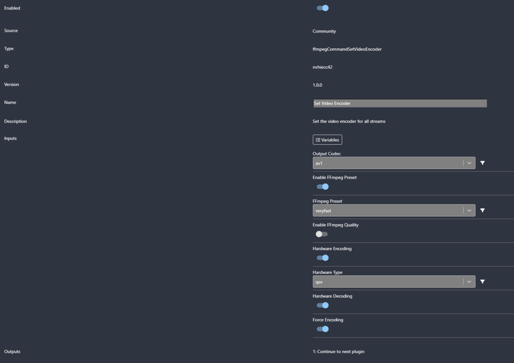

Also in the Video Encoder options, set your codec, in my case av1, and AI says its very important to use "veryfast" due to specifically the Arc or B580 compared to how igpu's handle this. Also qsv as hardware type is important.

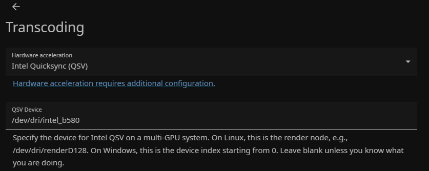

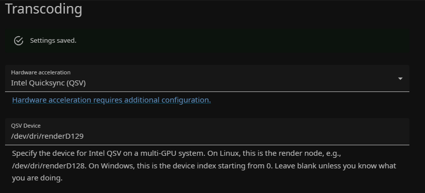

For Jellyfin, I also made a specific device mapping just in case: Not 100% sure its needed. I don't know how to actually test Jellyfin transcoding properly since gpu tops arent working in unraid right now.
In Jellyfin I specified QSV and typed the D129 device path.

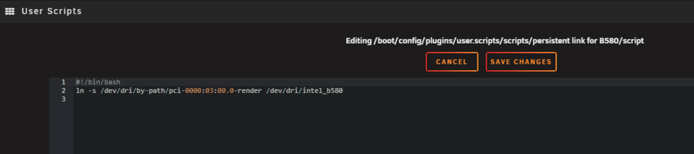

Type this in unraid CLI: ln -s /dev/dri/by-path/pci-0000:03:00.0-render /dev/dri/intel_b580
Now, we need to make that a script so it runs every reboot: Do this in User Scripts, running every first array start.
Finally: Change the extra parameters to: --device=/dev/dri/intel_b580:/dev/dri/renderD128
Now that were back to using D128, have to go back into the Flows Custom Arguments and change it to D128 from D129:

Don't forget to swap the render node for Jellyfin/Plex and any other containers needing the GPU..
