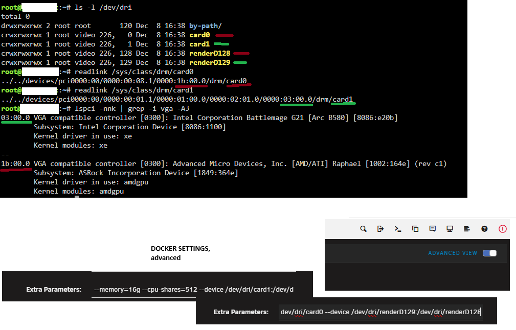

Don't forget to swap the render node for Jellyfin/Plex and any other containers needing the GPU.. Whether this is working, I still dont know, havent had time/ability to test.

Well, had to restart Unraid and the render devices swapped... Now my B580 is RenderD128 instead of D129. Since the physical slot is still /dev/dri/by-path/pci-0000:03:00.0-render the AI is telling me to change the Extra Parameters in the Tdarr docker. Since colons cant be used without errors, a hardlink needs to be made: Type this in unraid CLI: ln -s /dev/dri/by-path/pci-0000:03:00.0-render /dev/dri/intel_b580 Now, we need to make that a script so it runs every reboot: Do this in User Scripts, running every first array start. Finally: Change the extra parameters to: --device=/dev/dri/intel_b580:/dev/dri/renderD128 Now that were back to using D128, have to go back into the Flows Custom Arguments and change it to D128 from D129: And it finally works again... Moral of the story: Just buy Nvidia since thats the default people code stuff for...

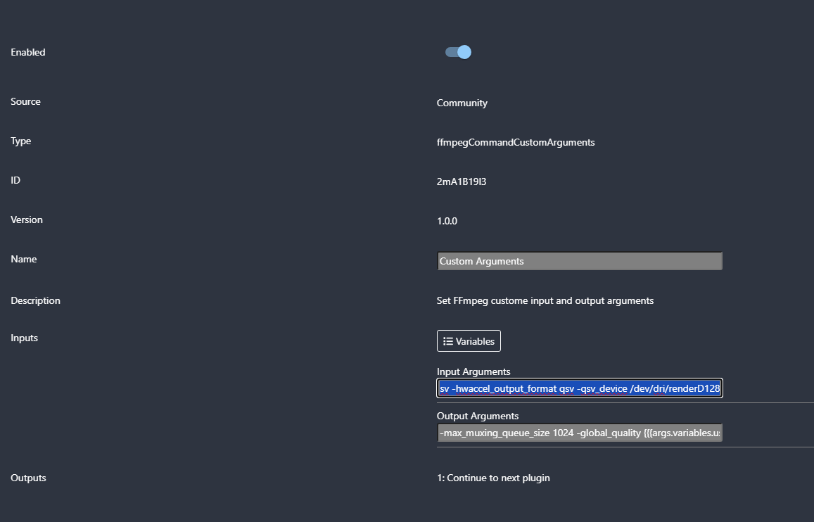

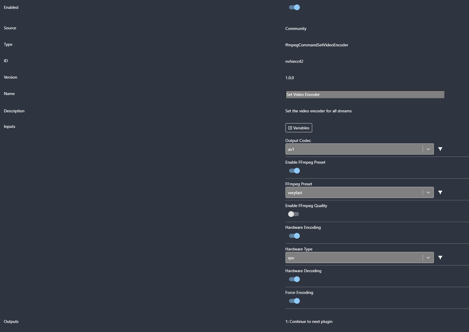

Okay, so I was still having transcoding errors but that was all fixed in my flows and docker extra parameters now. Successful transcodes with the below settings! I did these 2 commands in Unraid CLI per AI instructions, dont know if I messed anything up: chmod 777 /dev/dri/* setfacl -m u:99:rw /dev/dri/* In the custom arguments section of Tdarr, i had to do some inputs and outputs on suggestions with AI. I did some extra stuff but that wouldnt work without running the docker in privleged mode, which I didnt want to do past testing. Here is how I got the B580 working without having a privileged docker: Input: -hwaccel qsv -hwaccel_output_format qsv -qsv_device /dev/dri/renderD129 Output: -max_muxing_queue_size 1024 -global_quality {{{args.variables.user.qual}}} -extbrc 1 -async_depth 4 -look_ahead 1 -look_ahead_depth 30 -extra_hw_frames 30 -b_strategy 1 -adaptive_i 1 -adaptive_b 1 Some of that output above is needed, some isnt. I don't know which is required due to the B580 and what is needed per the flow instructions. The RenderD129 part is again, because 128 is my AMD igpu, 129 is the Intel Arc GPU. Also in the Video Encoder options, set your codec, in my case av1, and AI says its very important to use "veryfast" due to specifically the Arc or B580 compared to how igpu's handle this. Also qsv as hardware type is important. In the Docker settings (for both Jellyfin and Tdarr), I got rid of all the extra stuff, and now just have: --memory=16g --cpu-shares=512 --device /dev/dri:/dev/dri The latter part is what matters, and matches what others have said. I was just missing the stuff inside the docker itself. For Jellyfin, I also made a specific device mapping just in case: Not 100% sure its needed. I don't know how to actually test Jellyfin transcoding properly since gpu tops arent working in unraid right now. In Jellyfin I specified QSV and typed the D129 device path.

Ok, so I spent a bit of time with google AI and seeeeeem to have my B580 working on my 9950x platform. This is Unraid version 7.2.2 if it matters. Havent fully tested yet, wish GPU Statistics was working... Trick is to pass "--device /dev/dri/card1:/dev/dri/card0 --device /dev/dri/renderD129:/dev/dri/renderD128" to all your dockers that you want to use in 'extra parameters'. I found other tips to use "--device=/dev/dri", but this passes through both GPU's, and I really only want the actual discrete card passing through so I can use the igpu for a VM or something later. BUT FIRST you have to make sure that card0 and renderD128 are the right ones. I have my igpu enabled and that takes up card1/D129 on my system. Steps: Get plugins "Intel GPU TOP", "NVTOP" (I use this for the top in CLI, you may not need?), "GPU Statistics" (this one is bugged until the kernel updates and supports ARC and then Unraid adopts that, but at least its a quick check to see if it even recognizes my card) In unraid CLI, use these commands: ls -l /dev/dri This should print out your card0, card1, and renderD128/D129 and whatever else. readlink /sys/class/drm/card0 This will print out some stuff, what you want is right before /drm/card0 readlink /sys/class/drm/card1 This will print out some stuff, what you want is right before /drm/card1 lspci -nnk | grep -i vga -A3 This will let you match your actual video card to your card1/renderD129 or whathaveyou, for the above "--device /dev/dri/card1:/dev/dri/card0 --device /dev/dri/renderD129:/dev/dri/renderD128" Now, in my case I want to use card1 which is my B580, and not card0 which is my igpu. What this actually means, I have no clue. Actually, scratch that (just asked AI, editing post). You want card0 and D128 to be on the RIGHT side of the above command, whatever your left sides are. Just so happened that mine were this way. Ask AI why, it can explain somewhat easily. Pic example: I do the extra CPU resources and RAM settings for each docker, doesnt matter for this guide. Hope it helps!

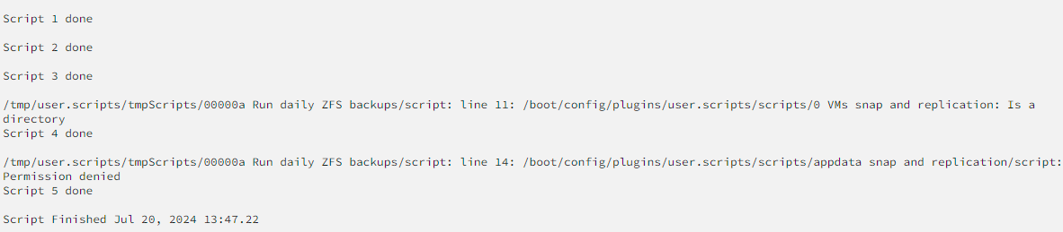

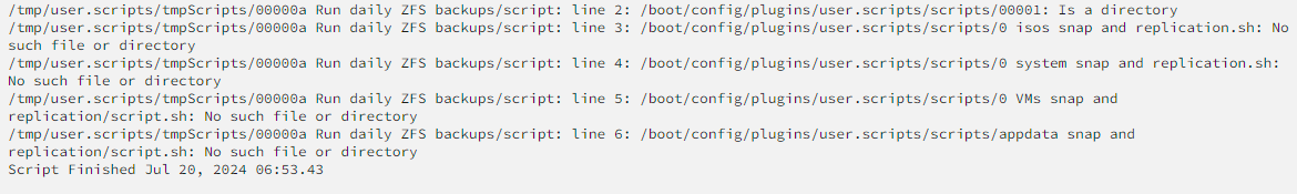

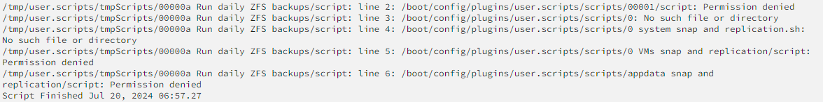

Tried #!/bin/bash chmod +x /boot/config/plugins/user.scripts/scripts/00001/script echo "Script 1 done" echo "" chmod +x /boot/config/plugins/user.scripts/scripts/'0 isos snap and replication'/script echo "Script 2 done" echo "" chmod +x /boot/config/plugins/user.scripts/scripts/"0 system snap and replication"/script echo "Script 3 done" echo "" /boot/config/plugins/user.scripts/scripts/'0 VMs snap and replication' echo "Script 4 done" echo "" /boot/config/plugins/user.scripts/scripts/"appdata snap and replication"/script echo "Script 5 done" echo "" got So it looks like it mostly worked (made them all different so I could text syntax because I added spaces...) But I checked the Iso snaphsot admin, and no new snapshots. Went and ran that script directly, and it did change the snapshot admin. So none of the scripts actually ran from the main script. Saw itimpi's comment that I got sh pathname wrong lol (I am new to this) tried: #!/bin/bash sh /boot/config/plugins/user.scripts/scripts/00001/script echo "Script 1 done" echo "" sh /boot/config/plugins/user.scripts/scripts/'0 isos snap and replication'/script echo "Script 2 done" echo "" sh /boot/config/plugins/user.scripts/scripts/"0 system snap and replication"/script echo "Script 3 done" echo "" sh /boot/config/plugins/user.scripts/scripts/'0 VMs snap and replication' echo "Script 4 done" echo "" sh /boot/config/plugins/user.scripts/scripts/"appdata snap and replication"/script echo "Script 5 done" echo "" And now its running sequentially which is GREAT. well, it ran script 1, script 2, script 3, failed script 4 due to syntax, and then ran script 5, which is what I expected! Fixed the failed script, and boom! Good to go! Thank you for both of your help! I have scoured this website search and google and couldnt find. Hope this is useful to others in the future.

I tried the sh pathtoscript first since that looked easiest lol. #!/bin/bash sh pathtoscript /boot/config/plugins/user.scripts/scripts/00001/ sh pathtoscript /boot/config/plugins/user.scripts/scripts/0 isos snap and replication/script.sh sh pathtoscript /boot/config/plugins/user.scripts/scripts/"0 system snap and replication" sh pathtoscript /boot/config/plugins/user.scripts/scripts/'0 VMs snap and replication' sh pathtoscript /boot/config/plugins/user.scripts/scripts/"appdata snap and replication"/script also did a quick test with sh pathtoscript /boot/config/plugins/user.scripts/scripts/00001/script.sh same result.. I dont understand what to write in the main script for foo_fighter's comments. (And apparently forgot how quoting works on this forum). Do I use the CLI to make a copy somewhere, put the command in the main script to make a copy daily then run that, something else? Welp, I learned the hard way that I really do need to figure out this main script, because I was running one of the backups when my 'restart once a week' script ran. Ended up in an unclean shutdown so doing a 2-day parity check, when I just finished building parity yesterday (made some drive changes) lol. Now I have the 5 schedules running AFTER the weekly reboot.

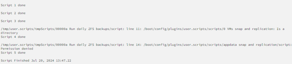

Actually, I'm stuck again. Been trying different options for the last 30 minutes. Keep getting errors trying to run the script. So far my script is: #!/bin/bash /boot/config/plugins/user.scripts/scripts/'00001' /boot/config/plugins/user.scripts/scripts/"0 isos snap and replication" /boot/config/plugins/user.scripts/scripts/"0 system snap and replication"/script.sh /boot/config/plugins/user.scripts/scripts/"0 VMs snap and replication"/script.sh /boot/config/plugins/user.scripts/scripts/"appdata snap and replication"/script.sh Ive tried using quotes, apostrophes, no punctuation, adding and removing .sh to the end. In each script directory, there are only 3 files: description, name, and script. I assume that I want to call out the script file to run, but I don't know the proper syntax. (also future note to anyone searching for this, the script files are on the flash drive) Edit: after some more process of elimination: Looks like a few of them are seeing the script, but getting permission denied...? Doesnt seem to make a difference between " and ' for the below scripts. But need to have one of them, and a /script at the end. #!/bin/bash /boot/config/plugins/user.scripts/scripts/00001/script /boot/config/plugins/user.scripts/scripts/0 isos snap and replication/script.sh /boot/config/plugins/user.scripts/scripts/"0 system snap and replication".sh /boot/config/plugins/user.scripts/scripts/'0 VMs snap and replication'/script /boot/config/plugins/user.scripts/scripts/"appdata snap and replication"/script Im thinking that the answer is in here, but I don't understand any of it and have been going at this for a couple hours now... https://www.baeldung.com/linux/shell-call-script-from-another Thank you for your patience/help.

Thanks! Was thinking it was more complicated with waits and whatnots (closest to coding I've come is editing macros in keyboard/mouse software). If the script waits for the previous line to be done before moving onto the next, then it solves itself. Awesome!

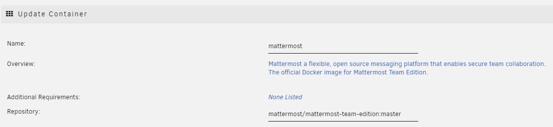

Hello, Is there any guides on how to get Mattermost Docker to work for a beginner? I am reading that I need other dockers or something to act as a database, but under Mattermost docker in the "Additional Requirements" field there is: "None Listed" Without know what to change, my Mattermost Docker is running and when I try to use the WebGui, I get "This site cant be reached". I try clicking on all the container settings and there arent any help-tips. I am assuming I am missing whatever needs to be changed in the 'DATASOURCE' and 'APP_HOST' settings since it has some username/password/ip stuff there but...... My IT/computer background is as advanced as: Watch youtube guide, download whatever docker, change the two settings the guide says to, and.... it works.. There just doesnt exist a how-to for this thing yet, unless I missed me. Thanks! Edit a couple weeks later: I gave up. Running Nextcloud instead of mattermost because there are guides in how to set up the database for it.
