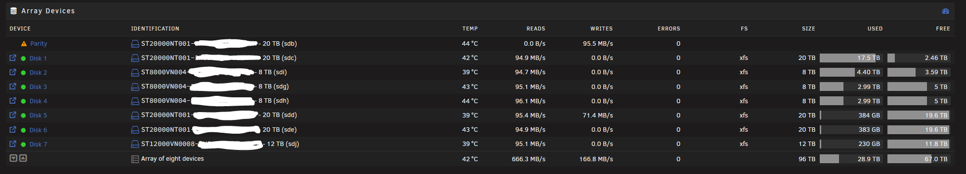

Hey all,
I had an Array with 1 Parity and 4 Data Disks. My previous config was:
20tb - Parity
20tb - Data
8tb - Data
8tb - Data
8tb - Data
I added 3 disks to the Array, but for some reason all of the new disks are appearing as 8tb. It seems like they're defaulting to the smallest sized disk in my current Array for some reason. The used space reported looks pretty crazy too. These are tested and working drives.
Since these are showing as 8tb and are below the 8tbs above them, I wondered if the order of my disks mattered for whatever reason? Other than that I'm not really sure why these would be reporting incorrectly like this.
Steps I've taken:
  • Checked Filesystem Status on all drives. All show good.
Any help would be appreciated. Thanks!

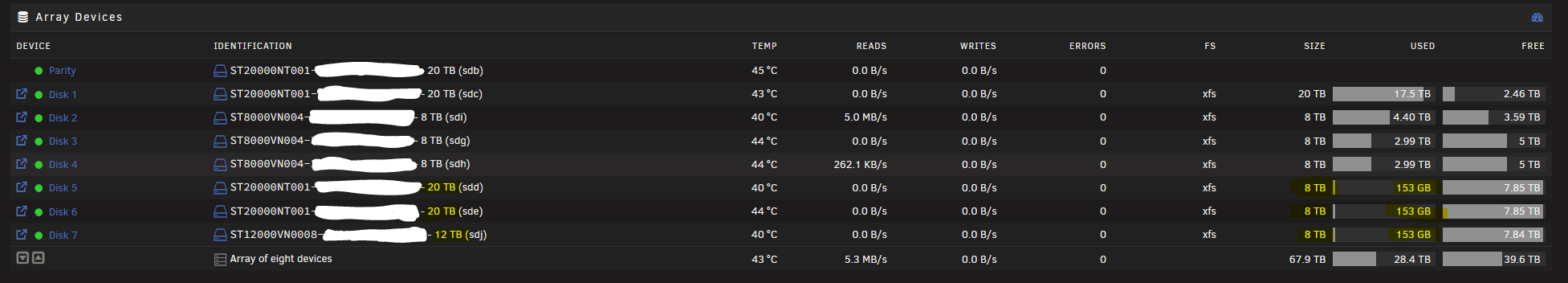

That suggests they had an existing smaller partition; please post the diagnostics to confirm.
Hi @JorgeB
Here is my Diagnostics file. Let me know if there is anything else I can provide.
A little more context on these drives. They were previously used in a Synology NAS, so they were not being used at full capacity. I didn't think that would matter after a clear and format, but figured I'd mention that as well.
One other thing to note is, there is no data on any of these 3 disks, so I'm fine with completely clearing them some other way if that is an option. I assumed the clear/format did that, but I guess not.
Edited by Skarm0ry
As suspected, they have multiple partitions, and Unraid uses the largest one:
Sep 11 08:35:03 Tartarus emhttpd: disk sdj 12000138625024
Sep 11 08:35:03 Tartarus emhttpd: part sdj1 8192 8589934592
Sep 11 08:35:03 Tartarus emhttpd: part sdj2 16785408 2147483648
Sep 11 08:35:03 Tartarus emhttpd: part sdj5 21257952 7990579855360
Sep 11 08:35:03 Tartarus emhttpd: part sdj6 15627875328 3998563581952
There are two options: rebuild the disks one at a time, Unraid will recreate the partitions, or manually wipe the disks and then rebuild parity, any doubts, please ask first.
