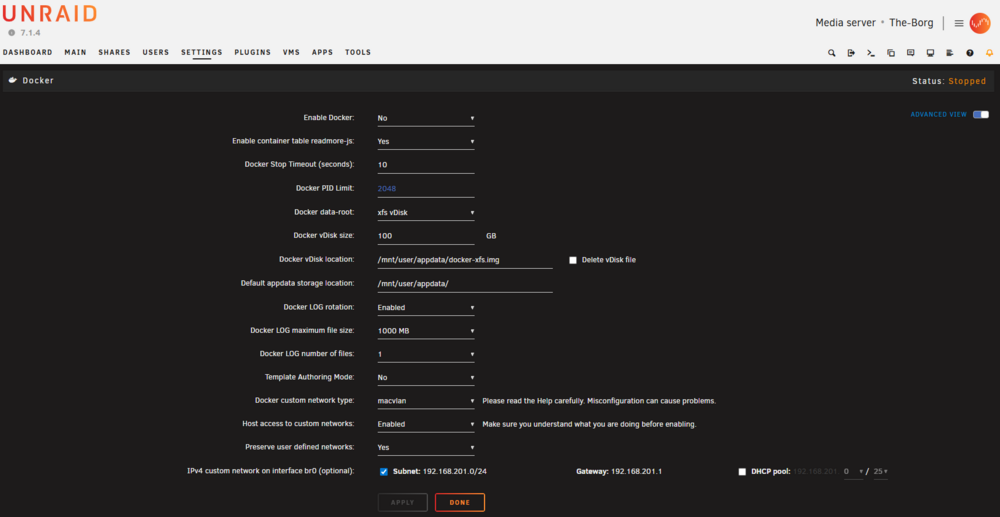

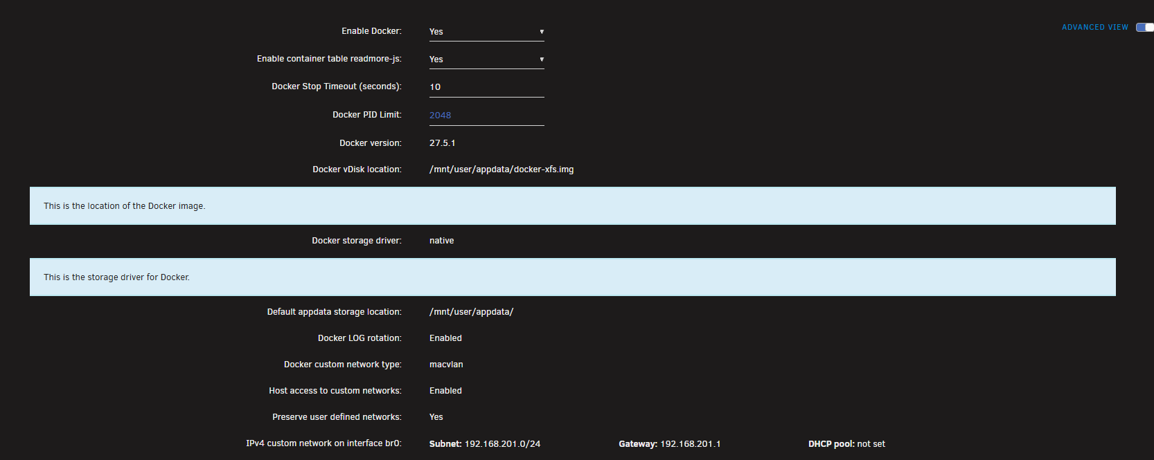

September 19, 2025Sep 19 Do I have docker storage settings configured correctly?Note: I am using BTRFS for my cache drive.Docker data-root: Directory vs. Image File?Is there a performance trade off between using a directory vs. image file?I prefer docker "data-root" to be a directory rather than a virtual disk (file), so I don't have to keep expanding the virtual drive.Any other tradeoffs to consider?Docker storage driver: Native vs. Overlay2?What should the storage driver be: Native or Overlay2?I am currently using "Native", and I see a folder called "btrfs" with another folder "subvolumes", and with a lot of files. Don't know why. Maybe I should use "overlay2"?What are the tradeoffs? Is there a performance tradeoff? Integrity?Thank you.

September 20, 2025Sep 20 Community Expert So, regarding the performance questions...Docker Data-Root: Directory vs Image FileImage file (docker.img / vdisk)Pros: One big file is simple for mover/backups. Less metadata overhead when copying/moving.Cons: Fixed size → if it fills up, you must expand manually. Adds an extra filesystem layer (Unraid mounts a loop device on top of your cache FS). That indirection can add slight overhead in metadata operations, especially on BTRFS. (I recomend 100 GB docker size for docker logs, docker image and adation data taht builds and gorws inside of containers.)Performance impact: On SSD/NVMe cache the penalty is small, but still an extra layer of abstraction.Directory (folder mode on BTRFS cache)Pros: Direct I/O to the underlying FS, no need for resizing, fewer layers. On fast BTRFS SSDs this is often faster for high-IOPS workloads (lots of small files).Cons: If mover ever has to relocate appdata, it must copy many small files (slower maintenance). Backups/restores less convenient than one file.Watch share setting... appdata should be a single primary location!Performance impact: Generally equal or better than an image file if you’re already on a dedicated SSD/NVMe cache.Conclusion: For performance, directory mode is typically the better choice on a BTRFS cache. The only downside is convenience (harder to move/backup vs one vdisk).Docker Storage Driver: Native vs Overlay2overlay2The Linux kernel’s optimized union filesystem. Handles image layering efficiently.Generally best performance for container start/stop, builds, and layer management.Lower copy-up overhead, faster metadata handling in most modern kernels.Recommended by Docker upstream as the default driver for almost all distros.native (btrfs driver)Stores container layers as BTRFS subvolumes (which is why you see btrfs/subvolumes).Gives you CoW and snapshot features at the filesystem level.Can become slower under heavy workloads with lots of layers or many small file changes (metadata overhead in BTRFS).More complex fragmentation behavior, sometimes needs balance/defrag maintenance.Conclusion:overlay2 on top of BTRFS cache → usually better raw performance and less maintenance hassle.native (btrfs driver) → offers advanced snapshooting features but can be slower and heavier in metadata overhead.Recommendation for your setup (BTRFS cache, SSD/NVMe):Data-root as a directory → to avoid vdisk overhead and resizing.overlay2 as the storage driver → for faster, leaner container operations.*Giving the performance over unraids default configuration and ease of backup.
