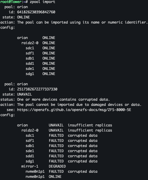

Hi All,
I am using Unraid 7.1 and am facing a bit of an issue with the ZFS pool.
Lets start with how i got here; I have an Ugreen NAS (DXP6800) have 6 drives configured in raidz2 and have an SSD configured as read cache. I wanted to replace the read cache drive with a different drive which I had lying around (bigger) and so I turned off the NAS and replaced the drive.
After replacing the drive I went looking in the zpool and removed the cache through the terminal seeing as the UI was not really helping things along.
I have been tinkering with the zpool and the UI for some time now and I have reached a point where I need to ask for help/pointers as the zpool is kind of borked.
If i do zpool import it looks like this:
I have 2 references to my zpool. First one (64xxxx) I am able to properly import using zpool import <id> orion and am still able to access all the files under /mnt/orion
however the unraid UI is completely borked as I am not able to browse anything in there and it does not recognize the pool etc.
I have tried many things to try to import the "invalid" pool to try to remove it, but no success as I cannot import a pool where the devices are corrupted.
Any help/pointers would be appreciated
PS:
I do have to say that I attempted the "new config" method to see if the unraid feature for importing existing zfs pools would do the trick, but this also didnt work. Everything works fine if I do it command line.
I have attached the diagnostics as well.
#pray

so, just to clarify so I'm understanding you correctly... as it looks like you messed up a special disk without informing zfs of the edit or changes... see warning at the end!
What Happened
  • You had a RAIDZ2 pool (orion) and attached an SSD as a special read-cache device.
  • When you physically swapped that SSD and manually removed it from the pool, ZFS left stale metadata device references in the pool config.
  • Now zpool import shows two pools with the same name:
    • Healthy pool (ID 6418…) → imports fine, all files accessible.
    • Broken ghost pool (ID 2517…) → marked UNAVAIL with “corrupted data / insufficient replicas” because the missing special vdev destroyed its internal config.
The ghost pool is confusing Unraid’s UI, which expects only one importable orion.
Some Key Observations
  • Your data pool is intact — proven by the fact you can zpool import 641826… orion and access /mnt/orion.
  • The invalid pool is just a stale configuration entry, not another real set of disks. It references corrupted/nonexistent metadata replicas.
  • The Unraid UI is choking because it sees both references.

Thanks a bunch for your detailed explanation. It helped me so much to understand the way Unraid deals with ZFS.
I was not using zfs master plugin (I tried to remain as native to the newest unraid as possible).
I tried all your pointers, however what solved the issue and made the ghost entry ultimately disappear was running zpool labelclear -f /dev/nvme0n1p1 which according the the pool was the "only" remaining disk that was still alive in the pool. The moment I did this, when i ran zpool import the ghost disappeared.
I do have to say that I ran the zpool import -f -o cachefile=/etc/zfs/zpool.cache 64182623996842760 orion which should have overwritten the cache, but this did not remove the ghost entry. So I dont think it was an issue with the cache, but the nvm disk which I was using as cache probably had some metadata remaining which was removed by the labelclear.
Once again, thanks a bunch for the extensive explanation and help! <3
