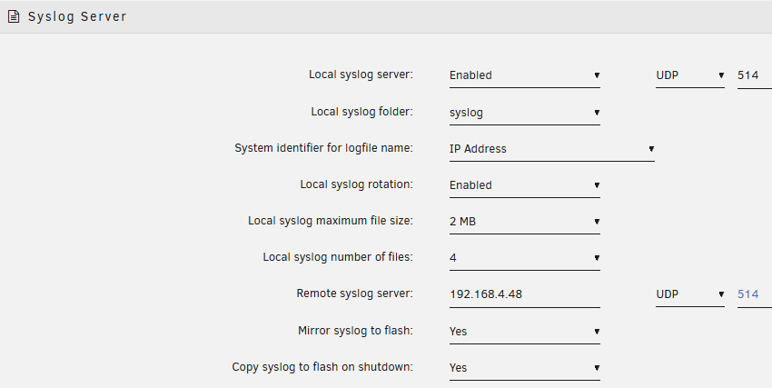

September 28, 2025Sep 28 Author Thanks for the quick response. I have setup Syslog Server with the following settings and will post updated logs from the next time that the server freezes.Will the Diagnostics will retrieve these logs? Edited September 28, 2025Sep 28 by Buzzman
September 28, 2025Sep 28 Community Expert 2 hours ago, Buzzman said:Will the Diagnostics will retrieve these logs?Nope, you need to get it from the syslog share.
September 28, 2025Sep 28 Community Expert 45 minutes ago, JorgeB said:Nope, you need to get it from the syslog share.It should also be in the diagnostics as well since the Mirror to Flash option is set as well as putting the serves address into the Remote Server field. Normally you only set one of those two fields.
September 29, 2025Sep 29 Author Thanks for the replies, I really appreciate them.19 hours ago, itimpi said:It should also be in the diagnostics as well since the Mirror to Flash option is set as well as putting the serves address into the Remote Server field. Normally you only set one of those two fields.OK, thanks for the advice. I will update my settings following troubleshooting.My unraid server has crashed several times since, with the longest it has been running approximately 30 minutes. I am struggling to even start the array to access the syslog folder. I managed to get a couple of sets of diagnostics and a copy of the syslog.There seems to be CPU-tainted errors but I am not sure how to determine the cause of these errors. Are there any ways to check the most likely cause of these errors?syslog-192.168.4.48.logtower-diagnostics-20250929-1433.ziptower-diagnostics-20250929-1458.zip
