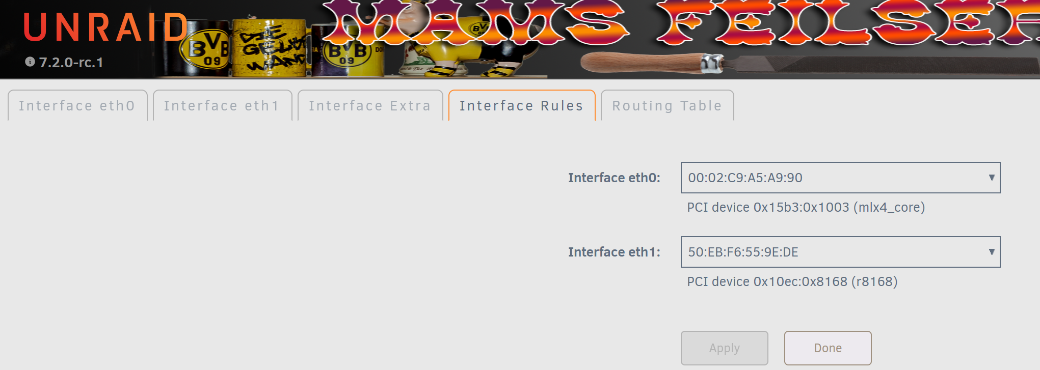

Set the NIC you want to use as the main one as eth0. Settings - Network Settings - Interface Rules
yeah, move it up in interface rules
You can simply pick the mac of the 10G one for eth0 and the other one to eth1 in the dropdown boxes.
(like shown here, mlx4_core is the 10G card)
