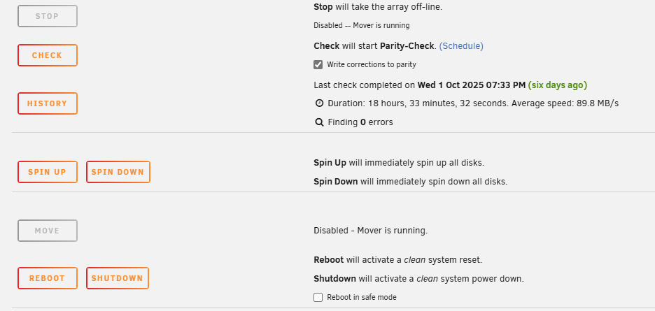

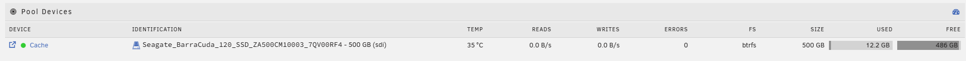

So today I clicked mover, to move all my files to the array, so I could set appdata to primary storage = Array & secondary storage = None, when everything was off the small cache disk. However I had forgotten to stop all my dockers & disable dockers from settings. So, I stopped them anyway and disabled dockers from settings so no files were being changed while mover is trying to run... I haven't stopped VMs as I am hosting some active websites in an Ubuntu VM which cant be shut off during the working day!!! However since starting the cache disk has been showing 12.2Gb in use and doesn't seem to be doing anything - even though mover says it's tunning;

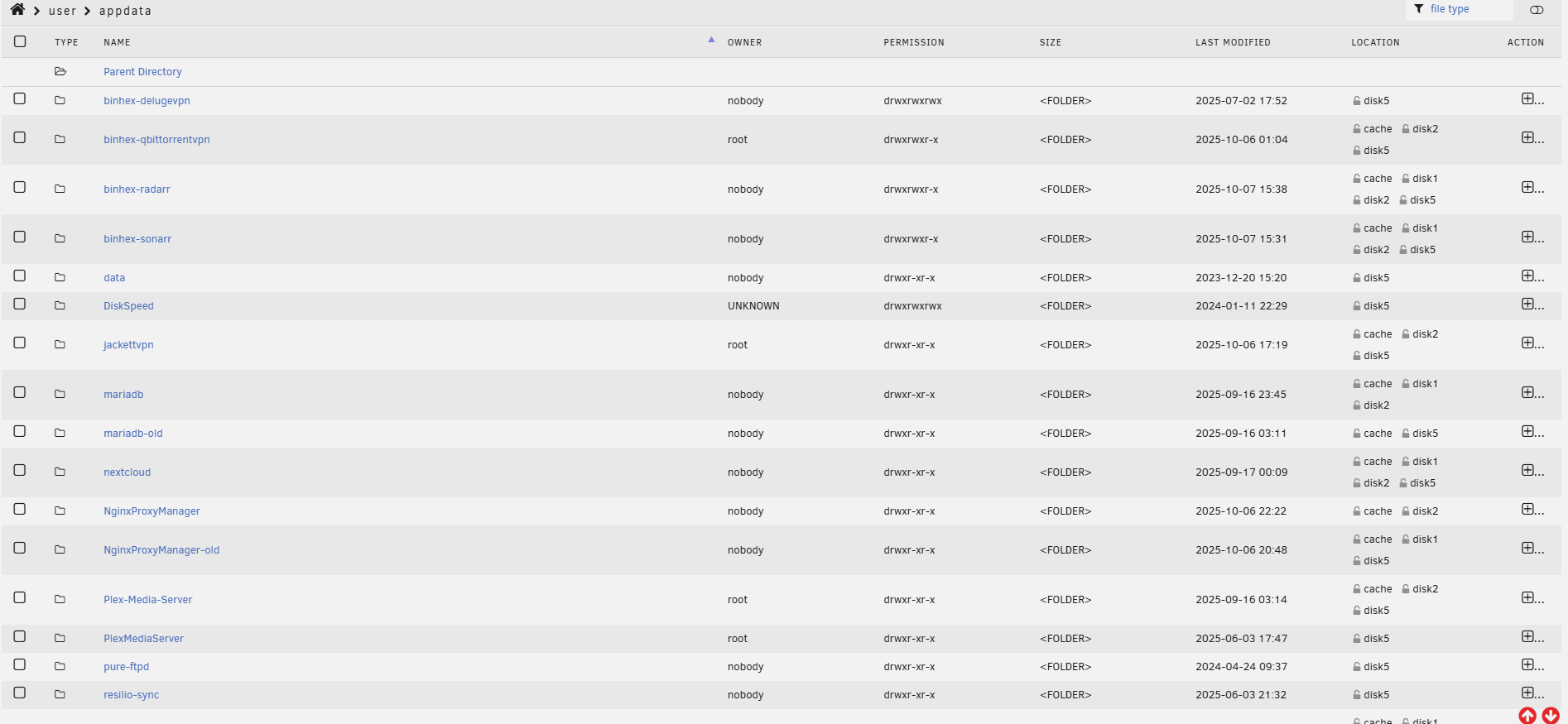

My appdata share is still showing all over the place...

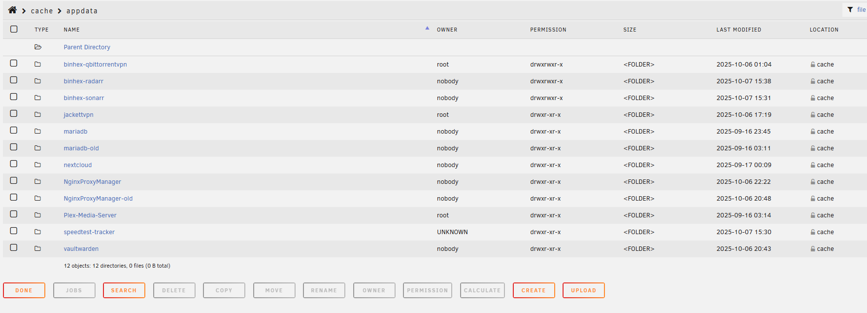

This is all that is on the cache disk at the moment;

Anyway, my question is why mover is taking so long to move 12.2Gb of files to the array (in about 30 mins it hasn't gone down at all!).

Mover will take a long time to move many small files, which is normal with appdata, recommend just waiting.
Thanks @JorgeB - just checked and an hour in it is down to 11.6Gb :)

OK been up for nearly 14 hours and mover is showing as stopped - so attached is the latest diags and cache disk still shows 11.6Gb not moved.... so am wondering whether I can just assume all these files are already on /mnt/cache/appdata/... and switch to the new (empty) cache disk.

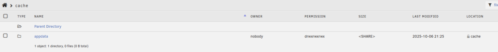

I think you really mean they went to /mnt/user/appdata? The path /mnt/user/cache/appdata refers to a user Share called 'cache' that contains a sub-folder called 'appdata'

One thing which I have just considered... what happens if I copy /mnt/cache/appdata/someapp/file1.abc to /mnt/disk3/appdata/someapp/file1.abc but there is already /mnt/disk1/appdata/someapp/file1.abc ?? How will UnRAID view this? Obviously as my appdata share is spread across multiple disks without checking EVERY file individually it is possible to have the same file in existence on two different physical disks, but in the same share??
Obviously its not practical to check for every file on every disk that /mnt/user/appdata/someapp/ is located on :(

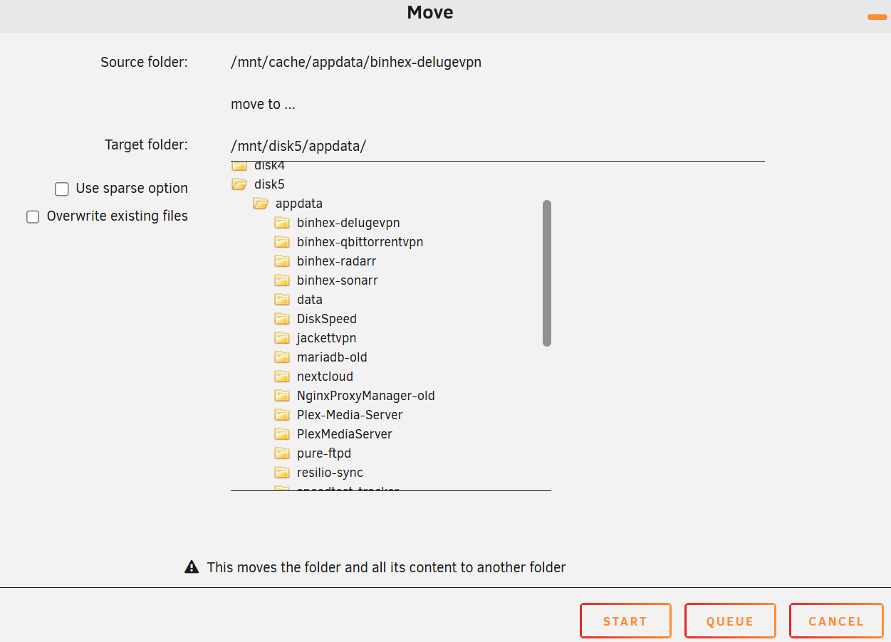

I am not familiar with Dynamix File Manager - but if this is built in, can I use it for the remaining files as I have only moved Radarr & it seems to be working OK... everything else is still located in /mnt/cache/appdata/... at the moment.
Just looking to see where in UnRAID it is!
Does this look the correct way to do this, I haven't started it till I know its correct...
Yes - you can get duplicate files. Unraid will show the first one it finds which can lead to confusing results as if for instance you delete one it promptly reappears as the other copy now gets uncovered.
Using Mover to handle the move avoids duplicates but can be significantly slower particularily if there are a lot of small files.
Is the screenshot I showed above the correct way to move to avoid duplicates?
Not necessarily. In theory files should not exist on other drives so you do not end up with duplicates. However if by any chance they already exist on other drives then you end up with a duplicate.
