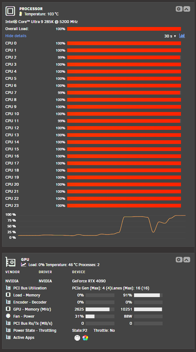

However, I wanted to use image analysis (with qwen2.5vl:32b) and there was a problem: my CPU usage went up to 100%.
(EDIT: in fact even with normal text requests with deepseek-r1 I have the same problem).
However, in unRAID dashboard, in the GPU section, I can see the Ollama logo in the active apps...
If I run nvidia-smi in the Ollama container, it recognizes the card but says "No running processes found."

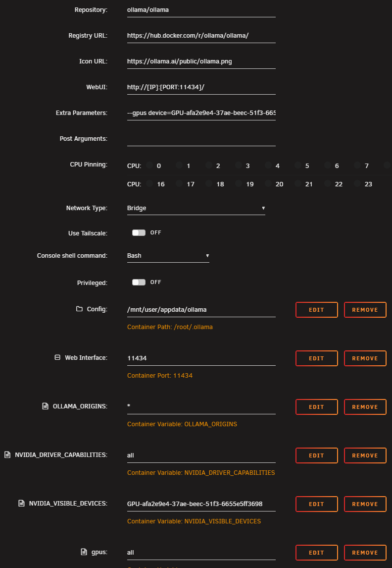

Here are some screenshots:
I tested everything: I added the environment variables "NVIDIA_DRIVER_CAPABILITIES: all," "NVIDIA_VISIBLE_DEVICES: GPU-afa2e9e4-37ae-beec-51f3-6655e5ff3698", I added "--gpus device=GPU-afa2e9e4-37ae-beec-51f3-6655e5ff3698" to the Extra parameters, etc.
Here is my config:
When I start Ollama and read logs, it seems to see the GPU:
