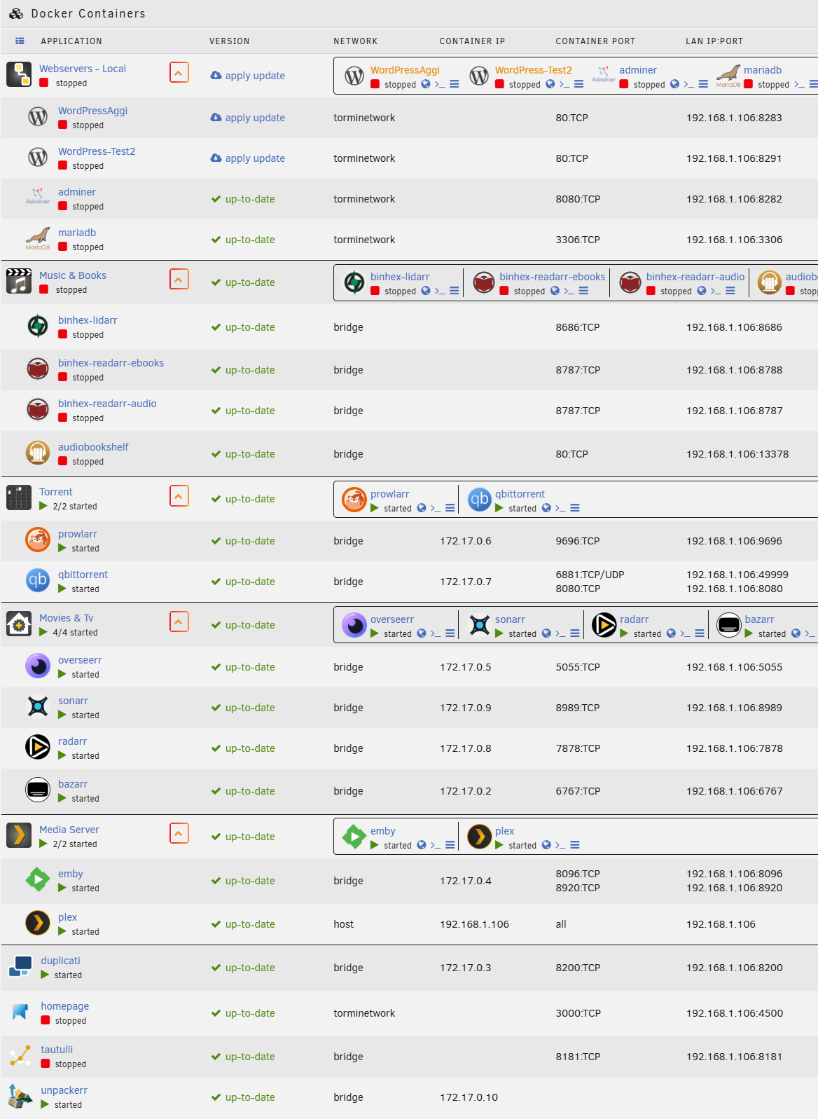

I also share an overview of my dockers:

I have not done anything else the last couple of months than to install an extra instance of wordpress, but for the last couple of crashes I am not even running those containers, as I was worried about a port conflict.
