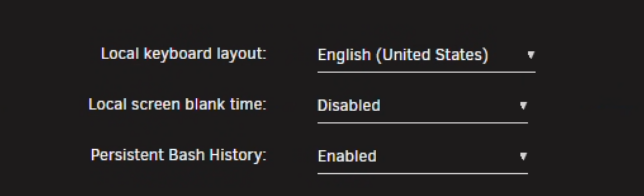

How can I keep the Unraid terminal display from timing out and blanking
The integrated VGA in this T440 server shows the BIOS and the Unraid boot process. It ends with a text mode shell display, but after 10 minutes or so, times out and the screen blanks. How can I configure Unraid so the VGA display controlled by the Unraid system remains active?
Solved by bmartino1
This was added as a setting in v7
Settings> Console settings>
Disable Screen Blank Time.
Otherwise you need to edit the main>flash and add a append option of consoleblank=0
Main > Flash > Syslinux
Edited by bmartino1
fix mispelling of grub line
Thank you! It even un-blanked the console on my running system when I set to disabled.

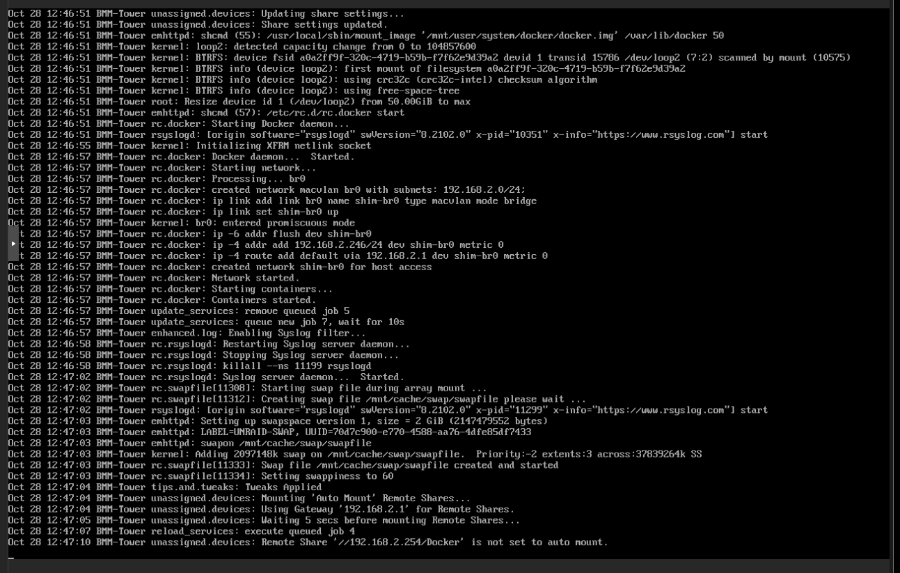

I'm trying to figure out why it takes something like 10 minutes to reboot Unraid so I want to know what's going on - if it is in Unraid, or the T440 POST.
Follow up question - Now that I've got the console monitor staying on, I'm thinking "what can I do with it"?
Is it possible to configure the system to copy the system log to the console? I might as well have some visibility on what is happening.
Now it just sits at the login prompt.

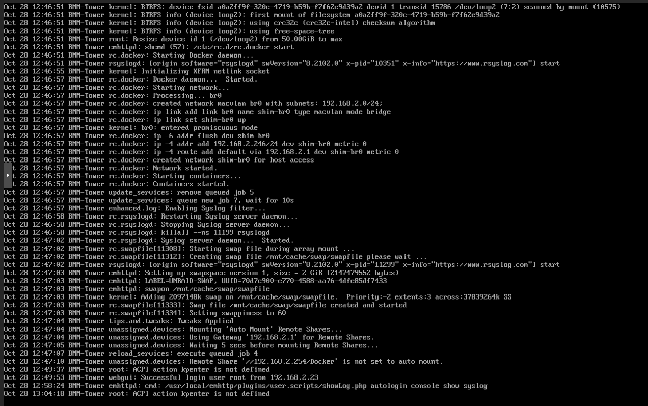

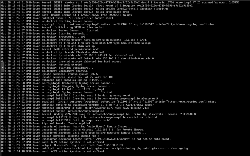

Since I don't have a keyboard attached to the console, I tried to initiate the tail command from an SSH session as a persistent, background process like this:
root@T440:~# nohup tail -f /var/log/syslog > /dev/tty1 2>&1 < /dev/null &
On the SSH terminal it displays the process ID as expected.
[1] 2090751
What happens is:
1) The console monitor (tty1) displays only this: "nohup: ignoring input and appending output to 'nohup.out'"
2) tail output goes into file /nohup.out, not the console display.
AI says "it should redirect everything to /dev/tty1, the behavior you're seeing suggests that Unraid's shell or nohup implementation may be overriding or interfering with the redirection — possibly due to how pseudo-terminals and device permissions are handled."
I'm learning to not trust AI advice regarding Unraid, so back to you to provide any insights on why this doesn't work as expected.
Edited by timg11

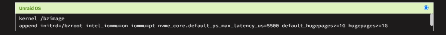

Main > Flash > Syslinux Configurations... where we can add adational grub syslinux configuration...
we need to set the console first! This is to guarantee it to always be at /dev/tty1 (at least this is the debain grub command may or may not work in unraid!)
append initrd=/bzroot console=tty1

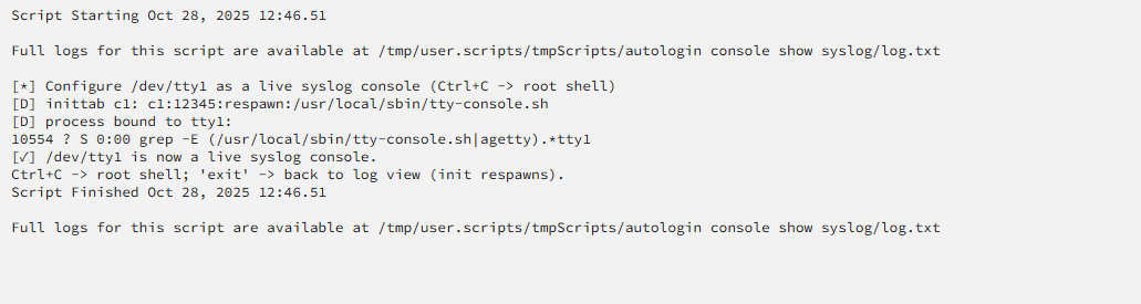

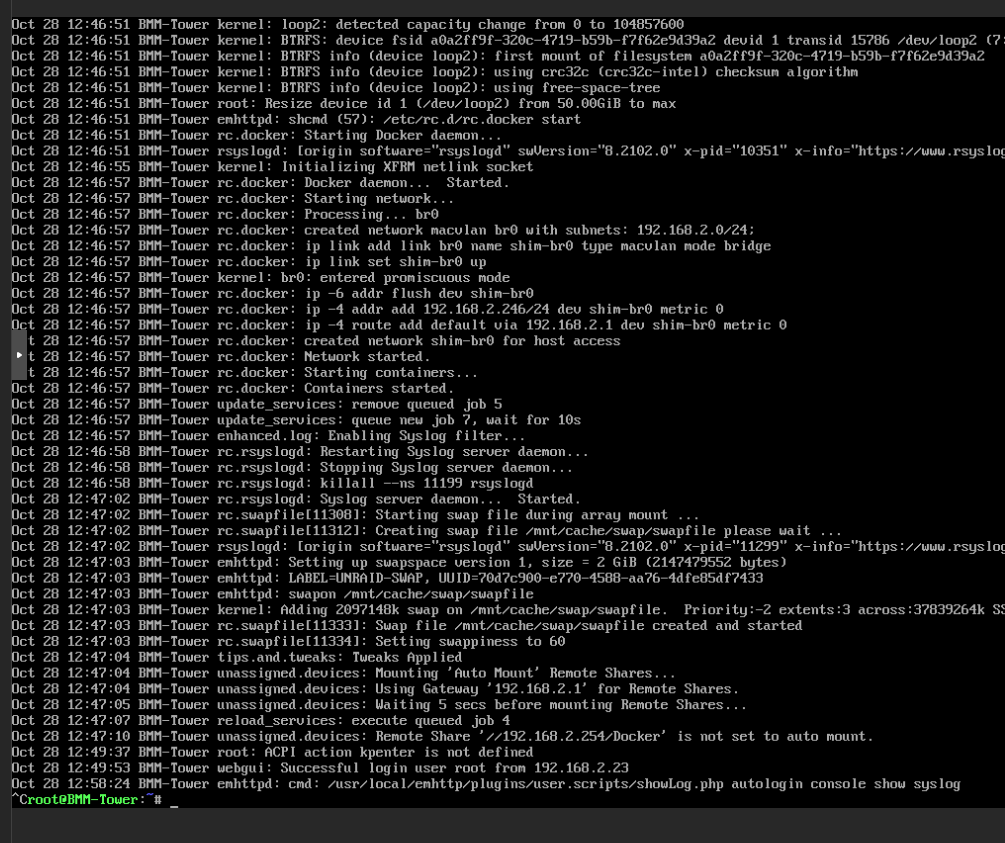

Example: Proof of concept. all headless:
Edited by bmartino1
spelling
this does make a securty vul if accessable in person:
@bmartino1- Wow,  I was expecting a minor tweak to my one-liner, but it takes a complex 72 line script!  But I can see it is better that passively redirecting tail -f syslog to tty.
It gives the syslog on the display, but then allows dropping to shell if I ever decide I need to hook up a keyboard to the server.  (I'm not worried about physical access - the server is physically secure.  I'm guessing the interactive shell after ^C is already logged in as root, rather than displaying the Login: prompt as it does now)

Thanks again for the tutorial - extremely helpful! I'll study up on these.  I've only been using Linux for about 10 years (Raspian, Ubuntu, Debian, and now Unraid), so that makes me a beginner compared to true veterans like you. (I did use Solaris on a Sun workstation in the late 90s and early 2000s, but that was just for Verilog simulation, and I had a company sysadmin to take care of it)
I already have the User Scripts plugin installed in Unraid so I can leverage that.
I can see that things could go very badly if this type of script malfunctioned. Would the effects of the wrapper and "Inittab surgery" be limited to the tty/agetty that appear on the monitor?  I.E. would SSH access and the web GUI be completely independent and unaffected if it became necessary to revert these changes? Or would recovery mean restoring my Unraid boot USB flash from a backup?
Correct this doesn't affect ssh for security, only the /dev/tty1 line. ssh will not see nor interact with it unless you use ssh to connect and call that tty console line by implementing other configuration and another type of wrapper.... it is limited to the tty 1and the Getty wrapper for /dev/tty1 only the variable defined at the top. if recovery is needed its always recommened to make a flash backup and unplug the usb entering the config folder deleting the user plugin script from the folder and plug the unraid usb in to boot like normal. When unraid boot it mounts the flash drive at /boot the user script is stored in the plugin folder in the config folder on the flash drive.
so recovery:
root@The-Borg:/boot/config/plugins/user.scripts/scripts# ls
DNS-sharfhoffen/ Fix-Hosts/ brandon-tailscale/ show_broadcasts/ tailscale-Stop/
DockerUpdateAllRunning/ FixShareServers-NFS_and_Samba/ fix-vhost0/ smb_replace_fix/
Error-syslog-notify/ ZFS-snapshots/ rsync-appdata/ systemctl/
Delete the folder holding the script so it doesn't run from the usb drive.
However, This script is fairly safe and kinda fool prof essential we make a script (the wrapper we want to run) and replace only the /dev/tty1 line in the /etc/inittab line. This is why I have a undo in the script at the bottom... to undo looks for our sed edit to remove. as you could edit the script and uncomment the text file so it will run at boot and remove itself leaving a wrapper script in /usr/local/sbin/tty-console.sh
??? I guess you cold ssh login and run the script... though its only affecting /dev/tty1 so ssh wouldn't gain root access...
On the physical console, you’ll see something like: /dev/tty1 (or tty2, etc.).
Over SSH you’ll see a pseudo-terminal like: /dev/pts/0.
since tty1 is not inside a shared tmux session... in order for this ttyl to be connected to the ssh you would have to run other lines to connect it... by editing the /etc/inittab line with a different wrapper line like...
# wrapper used by tty1 (e.g., /usr/local/sbin/tty1-wrapper)
#!/bin/bash
exec tmux new -A -s console /bin/bash
then once you have sshed into the system you would run something like:
tmux attach -t console
which would give you that consol tty line over ssh...
This would require setting it up beforehand... its also why i mentioned the screen application/command... for unraid we can install 3rd party application (like plugins) a Slackware extra package as with screen we could runn something in a screen disconnect from the screen connect to ssh reconnect the screen..
https://slackware.pkgs.org/15.0/slackware-x86_64/screen-4.9.0-x86_64-1.txz.html
you could put the binary package in /boot/extra to have this installed at boot for unraid 3rd party install:
https://slackware.uk/slackware/slackware64-15.0/slackware64/ap/screen-4.9.0-x86_64-1.txz
https://linux.die.net/man/1/screen
AS ssh makes a different virtual console, it is and will not affect on their console's tty terminal session.
Edited by bmartino1
spelling - forum werdness with links
