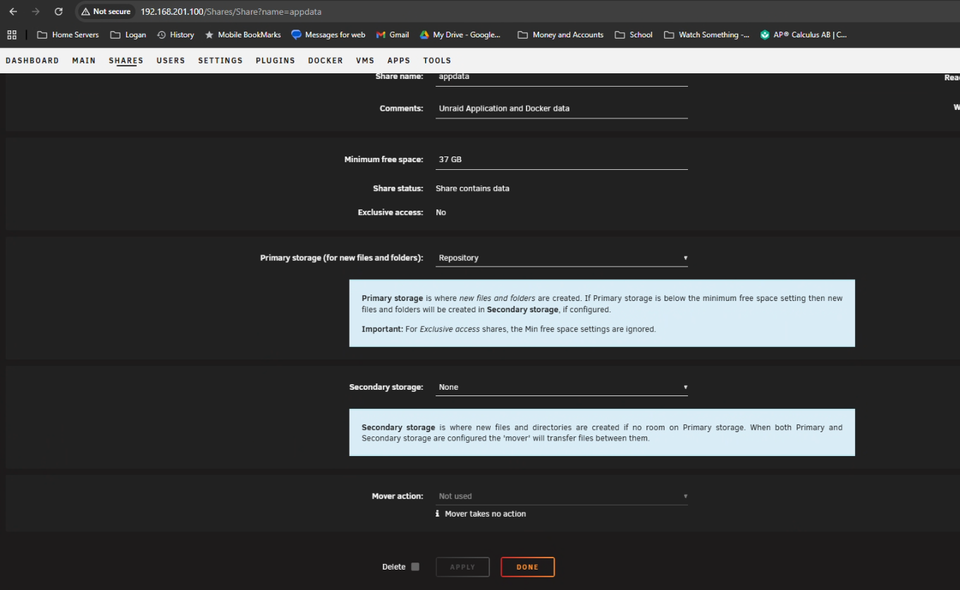

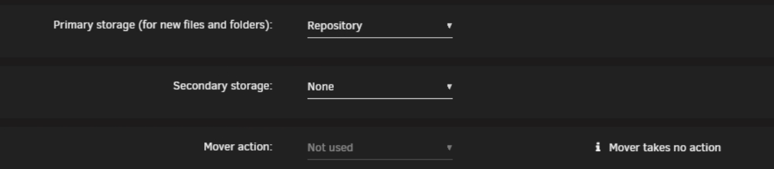

Make sure only primary is set...
confirm your share settings...

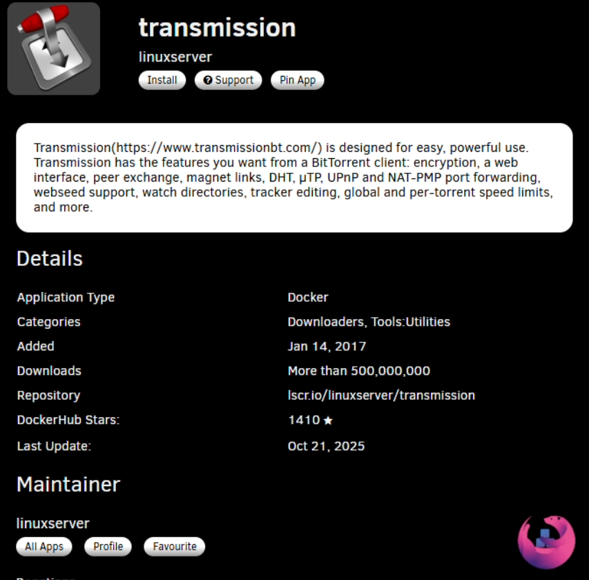

I prefer the linux server / linux IO transmission docker. lib torrent.
https://docs.linuxserver.io/images/docker-transmission/

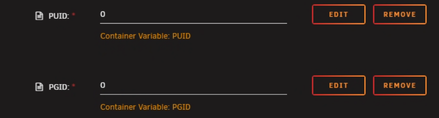

change UID and PID to 0 to use the root user.

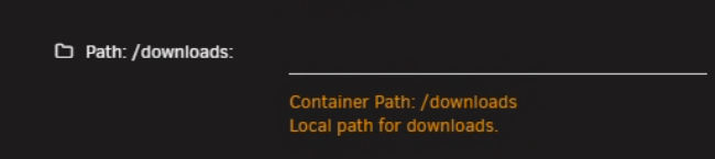

pre make the file paths on cache disk....
mkdir -P /mnt/user/appdata/torrent-download
cd /mnt/user/appdata/torrent-download
chmod 777 -R *
chown nobody:users -R *
