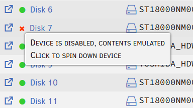

I did upgrade a 6 TB to a 18 TB disk7: Stopped array, replaced the old 6 TB disk with a new 18 TB disk, started array. After restart the array told "No or unmountable file system". So I did restart the array again. That's what I do see now:
The new disk is in the array but disabled. Is this disk DOA?

SMART for disk7 looks fine, and emulated disk7 is mounted with plenty of data.
Check connections, SATA and power, both ends, including splitters.

  1. Is there a way to tell Unraid to forget that disk7, put it in as a "new" replacement disk again, and start rebuild again?
  2. What I don't understand. If this disk is disabled, how does it report SMART values. Is it really disabled or not? That puzzles me.
You can rebuild on top, but make sure the emulated disk is mounting and the contents look correct before doing that:
https://docs.unraid.net/unraid-os/using-unraid-to/manage-storage/array-configuration/#re-enabling-a-disabled-disk-rebuilding-onto-itself
The disk is still connected, just disabled. If the disk dropped offline, then there wouldn't be SMART.
Yes, that did the trick. Thanks a lot. Rebuild is running - fingers crossed.
