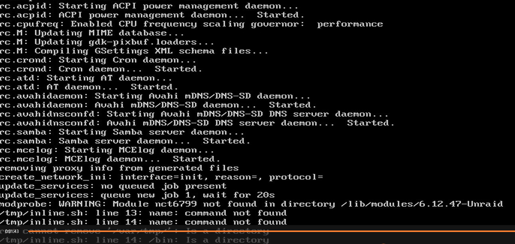

Just curious about this warning (since decades already)
What is this and how can I make it go away:
It appears at any boot on the screen, but does not show up in any log file.
I use some Dynamix plugins like System Temp and so on, and they show me nct6755 as the used driver.
So there must be a loaded module somewhere.
But still, why does UNRAID complain it cannot find it at boot time???
Strange...

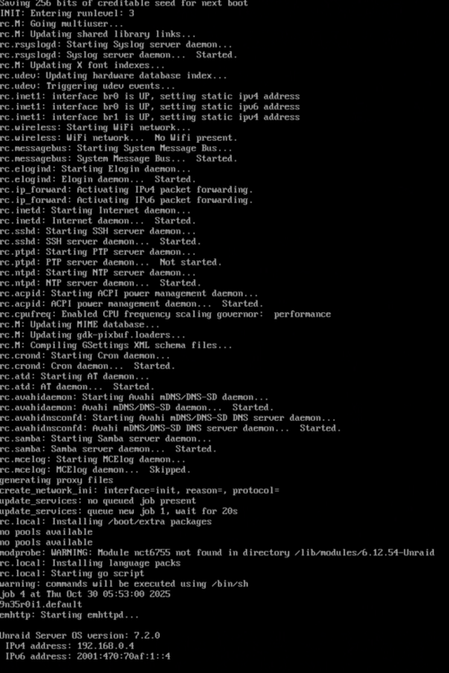

larger screenshot (cannot scroll back, but I think, its enough to see where/when it happens)
The 2 msgs "no pools available" are also strange...
(there is nothing in /boot/extra, so the install msg is just an info)

can't be. look at the screenshot
first comes the error message, a few lines later "executing go script"

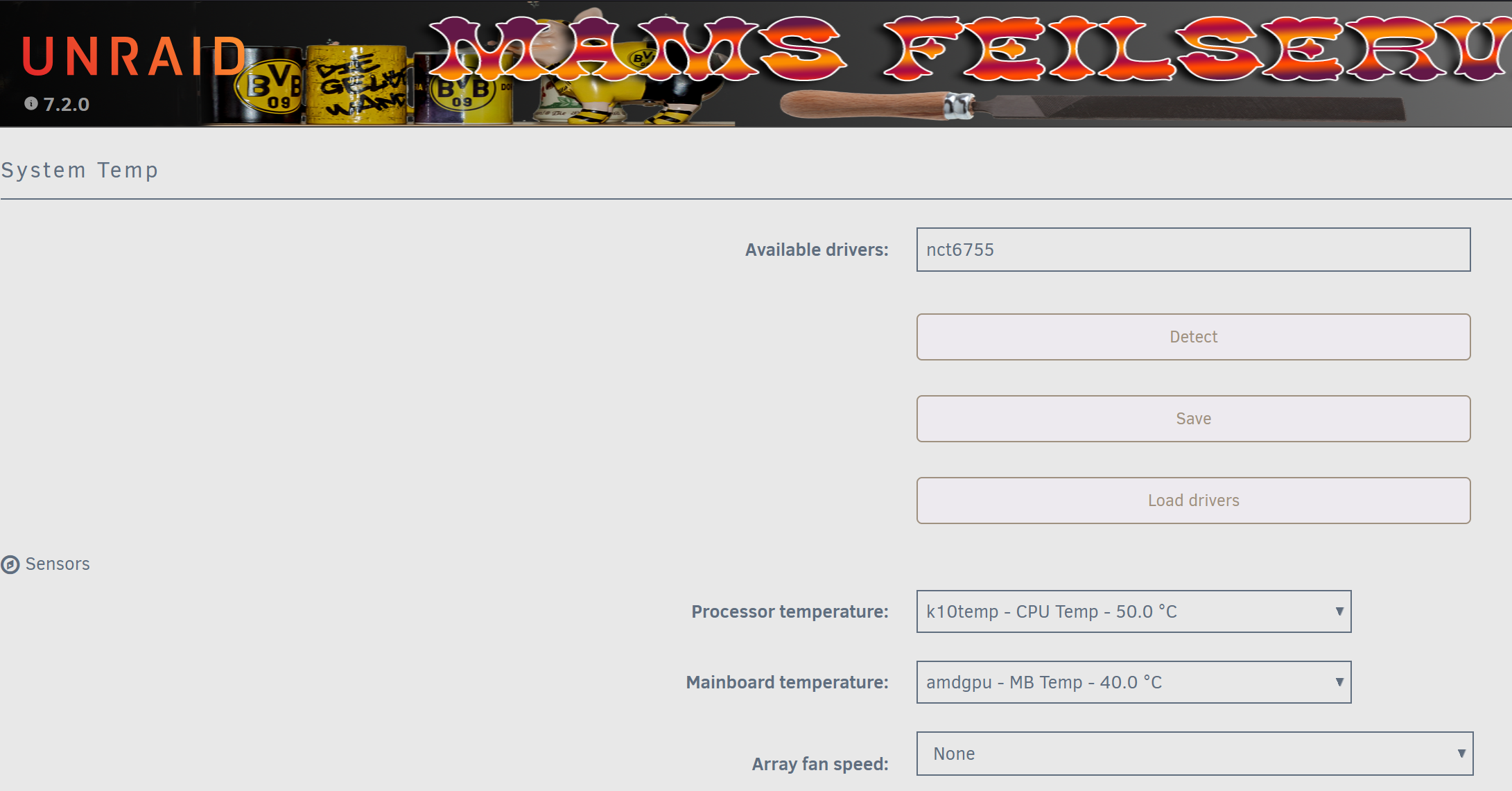

The "Dynamix System Temp" Plugin once detected the NCT6755 driver, which does not exist anymore. But on every reboot it wanted to load it.
No Temps and no fans anymore.
I've searched around and found the 6775 as the followup and added it to "go".
To fix it, open the settings in system temp, and just click on "detect". It will find the new driver and update the stored value.
(something that was missing at that UNRAID update long time ago)
Msg gone, fans and temp working

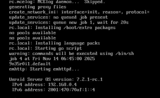

Yeah :) Your screenshot shows:
rc.local: Starting go script
warning: commands will be executed using /bin/sh
job 4 at...
which looks like an at job to me.
yeah, you are right, that "cache_dirs" scripts creates and launches an "at" command.
It is used for waiting for the array to become online and then start checking it.
I was not aware of this, just examined the script and saw it.
The other message "9n5..." comes from my own script "addtofirefoxsettings", it just echos the found active profile for firefox to be edited.
(harmless too) Too make it less mystic I have just changed the message to "Found Firefox Profile to edit under 9n35r0i1.default"
