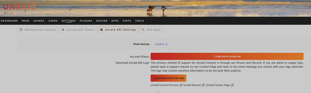

I have a seen a few topics in here similar to this, but not quite exactly matching. Since the 7.2.0 Beta and RC, and now the subsequent release if 7.2.0 I have noticed that when looking at the flash backup status page, the status wheel just continually spins. It appears that the backups are/have happened, but the status wheel just keeps spinning.....
I have noticed this behavior on both of my unraid systems. @elibosley maybe you have an idea?

35 minutes ago, JorgeB said:
Just below your topic:
Like I mentioned in my first post, "similar to this, but not quite exactly matching". I am not stating that backups are not happening, which is what is being said there. Two different issues.....
Right, if the backups were enabled, they should keep working. If they were not, you cannot enable them; it's a related issue.
Not trying to be difficult on my part by any means, but can you confirm this is actually an acknowledged issue? I saw you mentioned in the other thread that you "think" it was, but that was a few a weeks ago.
Just doing my part reporting issues.....
Edited by cybrnook
It is a known issue, but for now, don't have any info on when a fix is expected.
If you absolutely need to create a backup you can go back to an older version of unraid connect generate one. You would need to uninstall the current version of connect and go back to an older one. The one that seems to be the most stable is 4.12.0 copy the plugin URL for that version and past it to the box for the install plugins. Generate the back up then update to the current version of connect.
Backup issue has been solved in the latest version of unraid connect.
