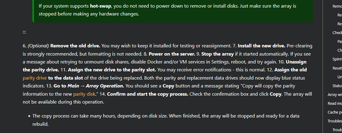

* To pass along to Limewire, the parity swap documentation is a little "messed up" - steps 6 through 14 inclusive are in one big paragraph. I copied the steps down as an aide memoire (in case anything bad happens with my Internet connection while the swap is on-going), so not the end of the world, but it could look better if someone revisits the section.
Can you expand on that? Looks normal to me:

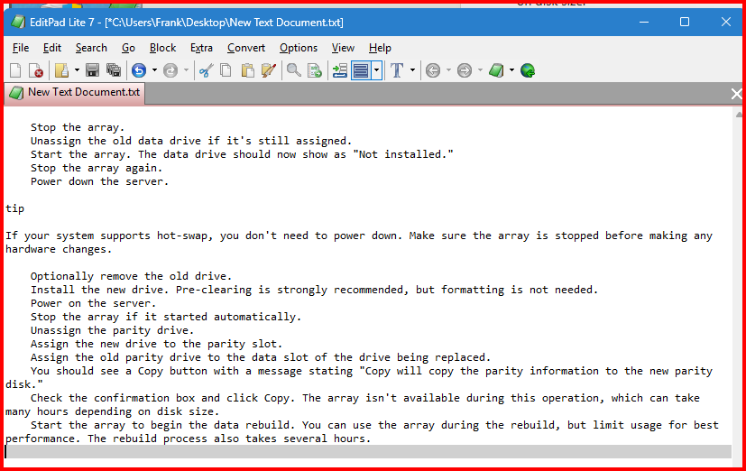

It might depend on the browser used I use Firefox. This is what I get if I cut and paste into my text editor:
That is why I try to get screenshots directly from the browser. Granted you can do a bit of editing to tidy thing up...
@JorgeB Sure, this is what I see in Floorp (Firefox fork)
Scratch that, I just refreshed the page and it all looks "correct" now. Must have managed to get a "not entirely correct" copy when I originally looked it up (yesterday/Thursday, I forget exactly when... Been a stupid busy couple of months for me at work)... Mea culpa, I guess.
