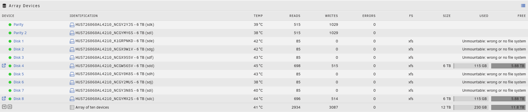

Hey there, I'm very new to unRAID and a lot of this stuff is still going over my head on initial setup. I'm moving my Plex server from an old/failing Synology NAS to a new dedicated server build using unRAID. I have a total of 10 6TB drives (old drives that I got for a good deal) that all spin up and have goo SMART readings. Currently there is no data on these 10 drives, my Plex files are safely housed on the Synology NAS for now, but it's only a matter of time for that. I followed Elevated Systems guide for how to set up my server but I'm having difficulties getting my hard drives to cooperate. For some reason only 2 of the drives are recognized when I start up the array:

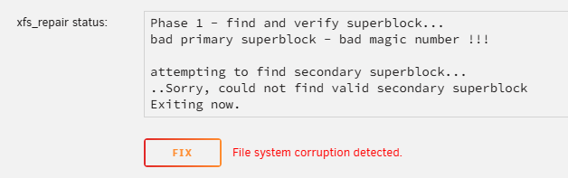

I've tried starting the array in maintenance mode and running xfs_repair but unRAID is giving me an error I'm not sure how to fix:

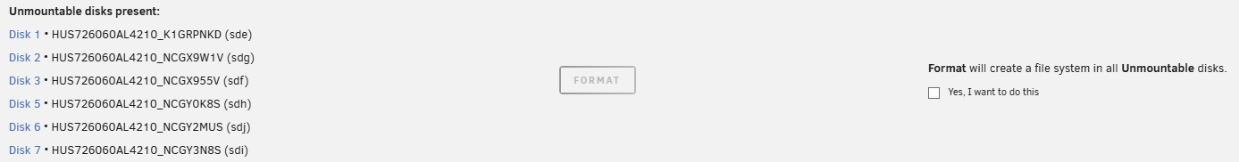

Thanks for the reply.
I did, yes. It still says they are unmountable
Edited by mattphillips43
did you also hit the "yes, I want to do this" Box???
pls retry and then post diagnostics afterwards

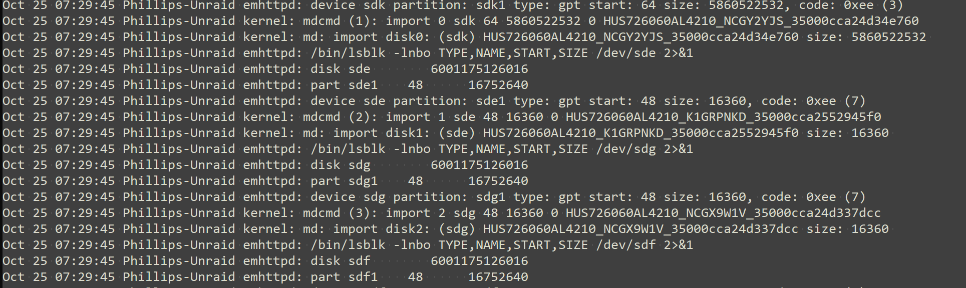

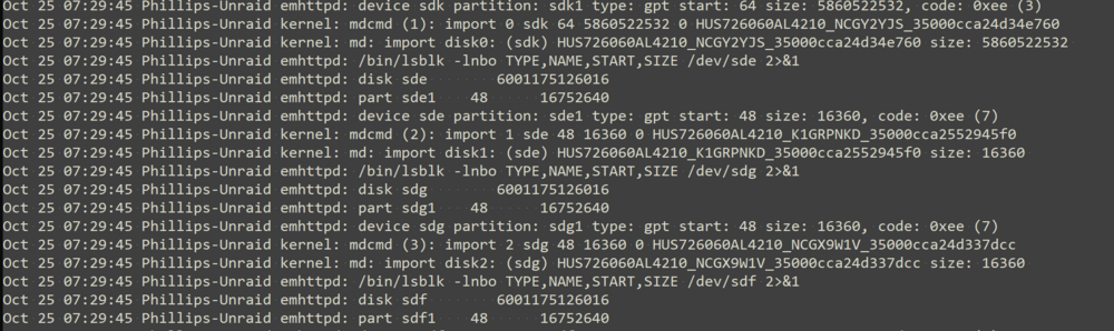

I see...
I guess:
This looks like to be the problem. The "unmountable" disks are only 16360 sectors in size, too small for xfs (or any other filesystem).
Looks like already the partinioning failed.
Strange
I guess this is something for @jorge I can't help you with SAS drives and controllers, sorry.

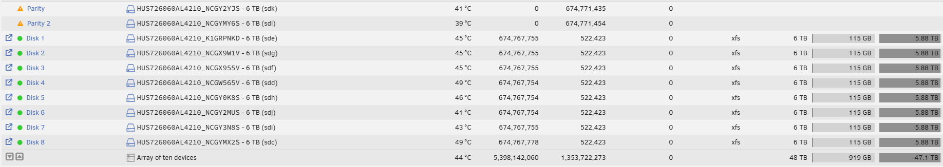

Thanks, I did that and it seemed to format just fine. It's running through a new parity check now but so far no errors. All HDDs are showing with their full capacities with a total array capacity of about ~47TB.
