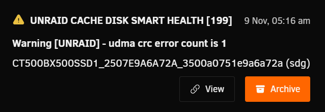

UDMA CRC Count is 1
I have another disk notification appeared today...
The machine which is listing this (HP Proliant ML310e v2) has a disk enclosure so I dont think this can be a cable/connection issue.
Do I need to worry about this error?
I haven't been able to reboot it yet, to see if it clears!
I have attached diags... any thoughts appreciated.

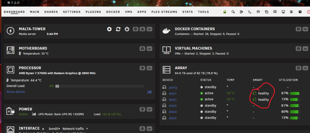

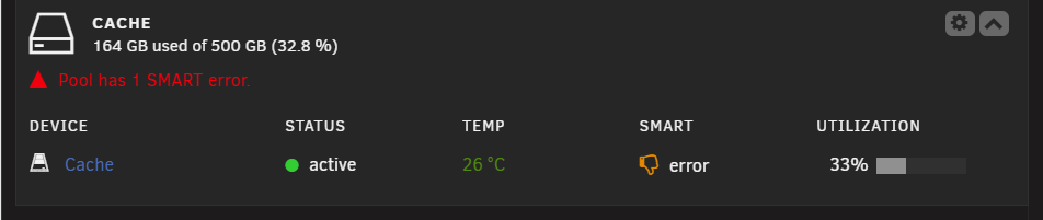

Clear the error by clicking on the fail icon on the Main Tab.
Monitor, if you get more errors, post details and diagnostics.
Most CRC errors are the result of data corruption in the transfer from the hard disk to the HBA interface. Basically, we are talking about the SATA data cable and the SATA connectors. And the error is always corrected by resending the data. It does slow down the data transfer rate but unless you are having hundreds of errors per hour, you would never realize that. It will keep popping up a notice which is much more annoying than any other effect of it. I believe the notification can be suppressed in the ARRAY section of the Dashboard. But the notification will reactivate should the count increases again.
Thanks.... although I dont actually see a "fail" tab - is it somewhere else;
Oops - My bad. I meant the OTHER main tab. The one my server initally loads, called DASHBOARD. 😄
Sorry about that.
Sorry about that.
Ah, thanks - found it...

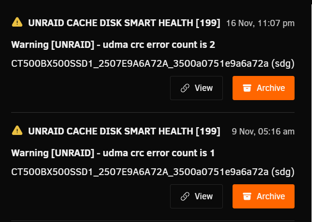

OK... today I received another error... now showing that UDMA CRC Error Count is 2...
So, I will remove the RAID enclosure and check all the connections are clean and well seated... but cant do this till the weekend.
