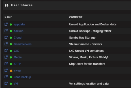

domains (as you can see in my picture I went with VM a place where unraid defaults saves Virtual Machines.

So no not crazy on starting over. but you want to have a layout before implementation to know where what is and what is happening with your data.

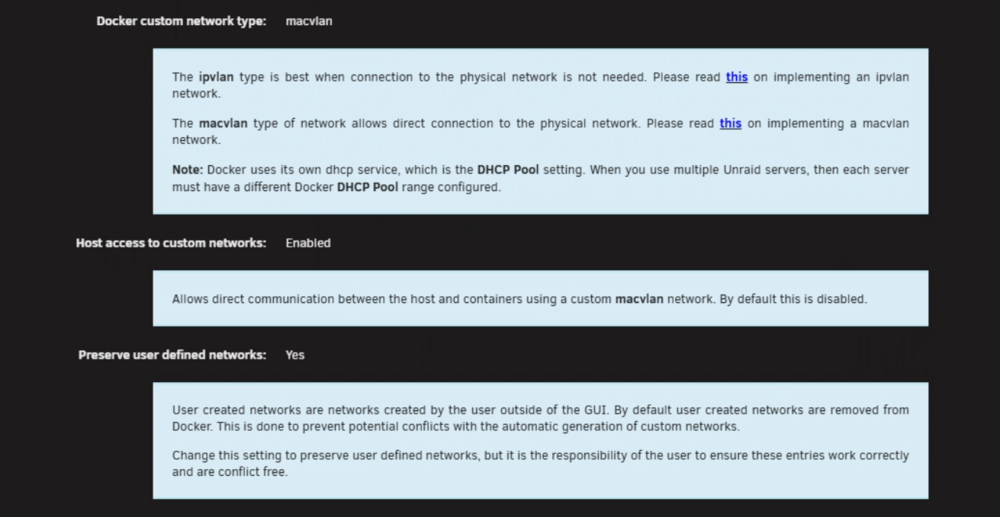

Advance docker settings:
*More to do with layer 2/layer 3 issues latter and giving a custom br0 docker lan anatomy with macvlan...

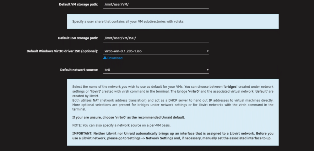

Vm settings:
*more with new vm creations on defaults paths, settings and how things are generated latter.

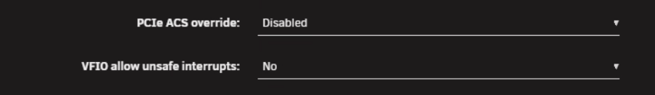

What vm? any hardware passed? Depending on hardware installed and passing devices into a VM.

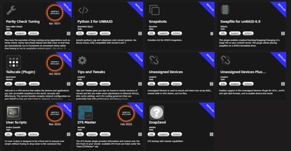

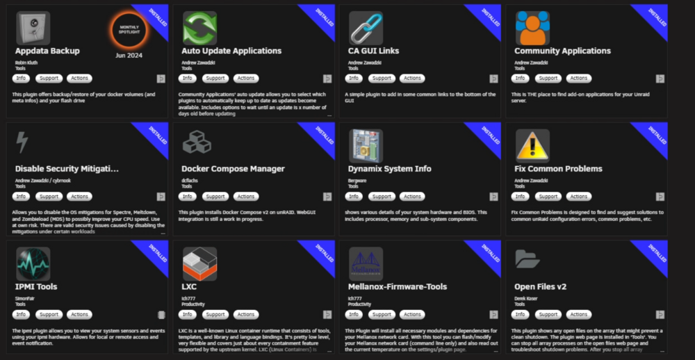

Plugins! Example per CA what I have:
Most are optional...
the mains are user scripts, unassigned devices, fix common problems appdata backup. tips and tweaks is a nice one as well give you the ability to click in the web ui and get a short description of and documentation on the setting... the blue boxes seen above...
