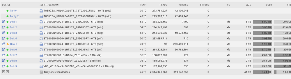

Stats on the diags are strange; there are 3 disks showing a considerably slower read speed, but all 3 have exactly the same, post a screenshot from main with the toggle set to show the drive's real time speeds.
Thanks, here is the screenshot:

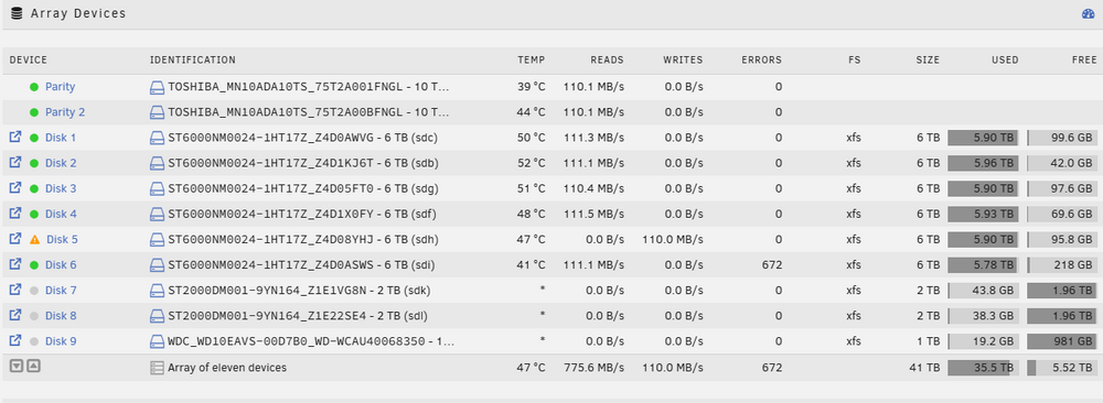

Speed has increased but I suspect because its at about 95% complete, before this it was a constant 23MB/s

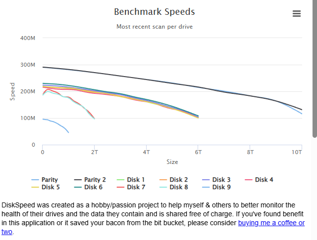

You may have a slow disk; run the diskspeed container after the rebuild finishes to see if all disks look normal.
Just running disk speed now. Will post the results shortly.

Here is the speed test results

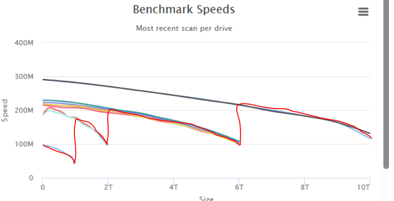

Speed will be much slower while the 1TB disk is involved; it will speed up a little after that but slow down again while the 2TB disks reach the inner sectors, after those are done, it should be much faster until reaching the inner sectors of the 6TB drives, and so on, follwing the red line:
I see, thanks. These small drives are only there for the time being to give me enough space to migrate all my data off my Qnap, once its moved over I can then recover the disks from my Qnap and start swapping out the small old disks.
