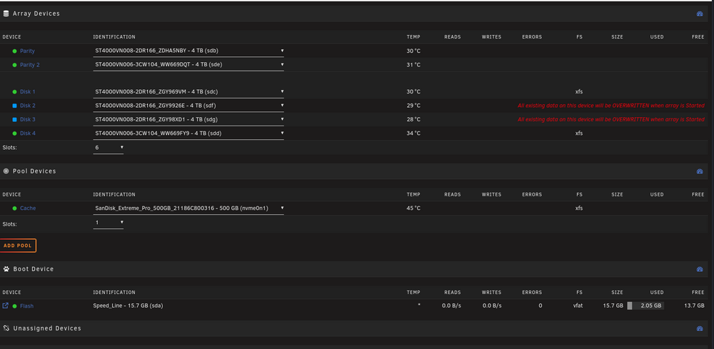

Emergency - Unraid won't mount 2 existing drives without erazing existing data
Help !
I had my array started in maintenance because I wanted to test if I can launch a VM with at least the SSD Cache installed.
Now after replugging everything back, I cannot add my disk's without having 2x4TB erazed..
Why can't I just add those disk's back to the array?
I also don't remember in which order they where assigned.

Didn't work. Disk's are being detected as normal but it won't start the array in the previous order. I have a flash backup but I dont know if I can just replace certain files on that stick with array info's like the super.dat

I just checked a flash backup to find the disk order as it was before.
How do I use the "new config"? Do I need to unassign all disk's before I do that?

I know the correct disk order now.
Both are mountable at least in the "Main" tab.

They are both unassigned from the array and I could mount them via UD, but I cannot see an "read only " mode.

Nope, you can keep all assignments, then just reassign the two missing disks in the correct order, assuming they mounted correctly with UD (and make sure to unmount them), then check "parity is already valid" before array start, if all looks good, run a parity check.
I resolved it myself in the following way:
!This requires you to have an backup of your flash drive without having changed your disk's in any way!
!! This is not recommended if you have experienced a faulty Disk !!
(In my case I unassigned all disk's from the array, but this step is maybe not necessary)
  1. Shut down your server
  2. unplug your USB drive, and mount it somewhere where u have a backup available
  3. backup your current USB drive
  4. after that replace your config/super.dat on the USB drive with the one from your flash backup
  5. replug into your server and boot.
Everything should now be as it was before.
