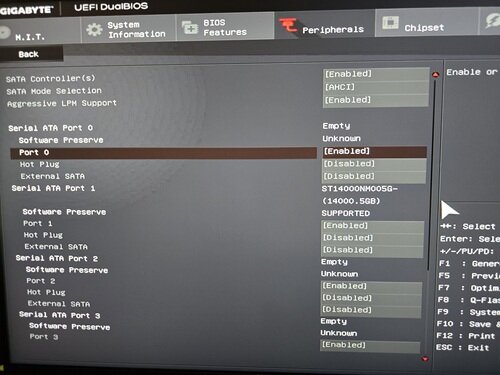

Can you see the disk in BIOS?

My motherboard is Gigabyte GA-H170-D3HP ATX LGA1151. It's an old gaming desktop rig.
How do I enter the BIOS to check?
Typically by pressing the delete key during post.
Sorry had a brainfart.
Unfortunately, only 1 of 2 drives show's in BIOS.
Every other SATA Port (0-5) shows Empty
Disk 1 is connected to SATA Port 0

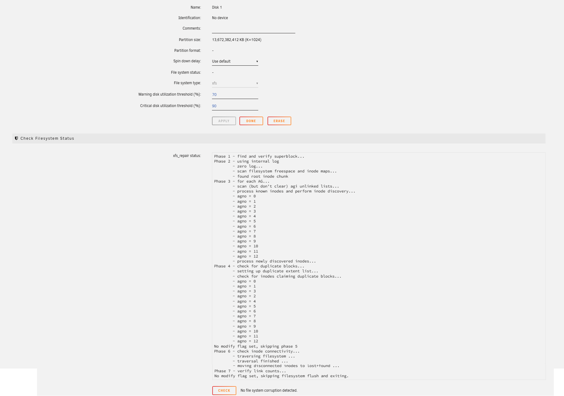

I entered maintenance mode to Check Filesystem Status. It appears Unraid can talk to the Not Installed Drive but doesn't find anything wrong?
That is to be expected if parity is valid so it can be emulated perfectly.
It is not clear from your earlier answers that you realise if a disk fails then Unraid can emulate it using the combination of parity plus other data disks (if any) and act as though the disk is still present.
Ok I missed that detail. I wasn't aware that a filesystem check on a disk can be completed by parity emulation.
