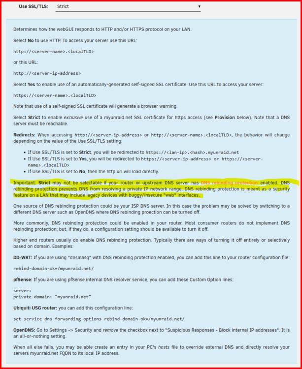

Following the video carefully and enabled provisioning, unlike the instructor, I get an error when clicking on the provided long URL. (I have tried this previously with an error as well).
I get a similar error with Chrome.
The provisioned link does not work.
I used the provided url: https://192-168-60-235.2855c481cd2ee31f586ef3f634076199d1b48eae.myunraid.net/

That suggests to me your router is not correctly configured to port forward the HTTPS port.
Be sure that you have read the help for setting the usage of SSL/TLS. There are a few gotcha's....
I went into my router, dd-wrt, and set Port Forwarding: set my Unraid at "Protocal TCP" and" Port From 80" with the "IP address" of the Unraid Server "to Port 443."
Same error when I click on the fore-mentioned long link. As screen capture. We can't connect to the server at .....
