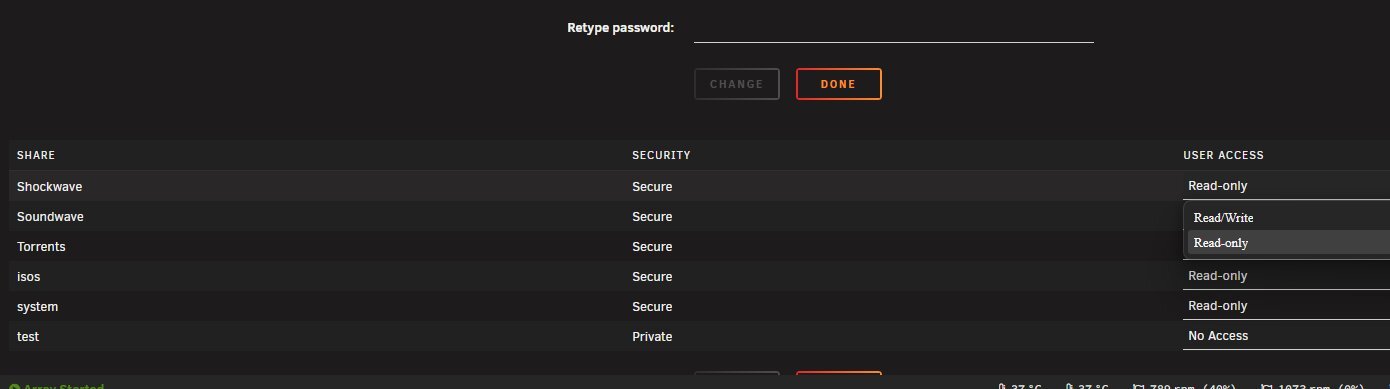

The shares that are not working are all of them (test is not accessible at all. that one is new). The shares are Shockwave, Soundwave, Torrents, isos, system and flash. Those ones I can read files, but not create/delete/modify via network.
test was created one or two days ago. I can't even have read access on either a real win11 machine or a kubuntu laptop. VMs on my win11 machine behave the same.

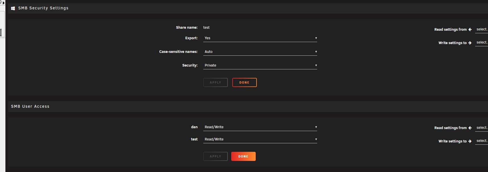

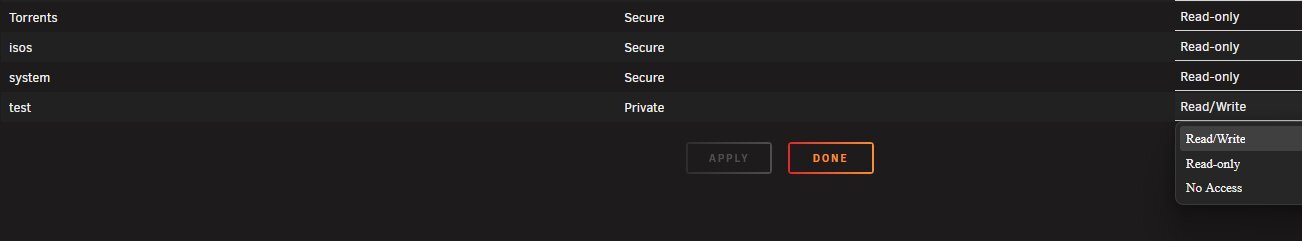

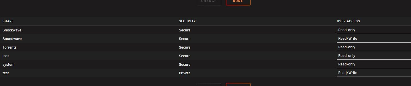

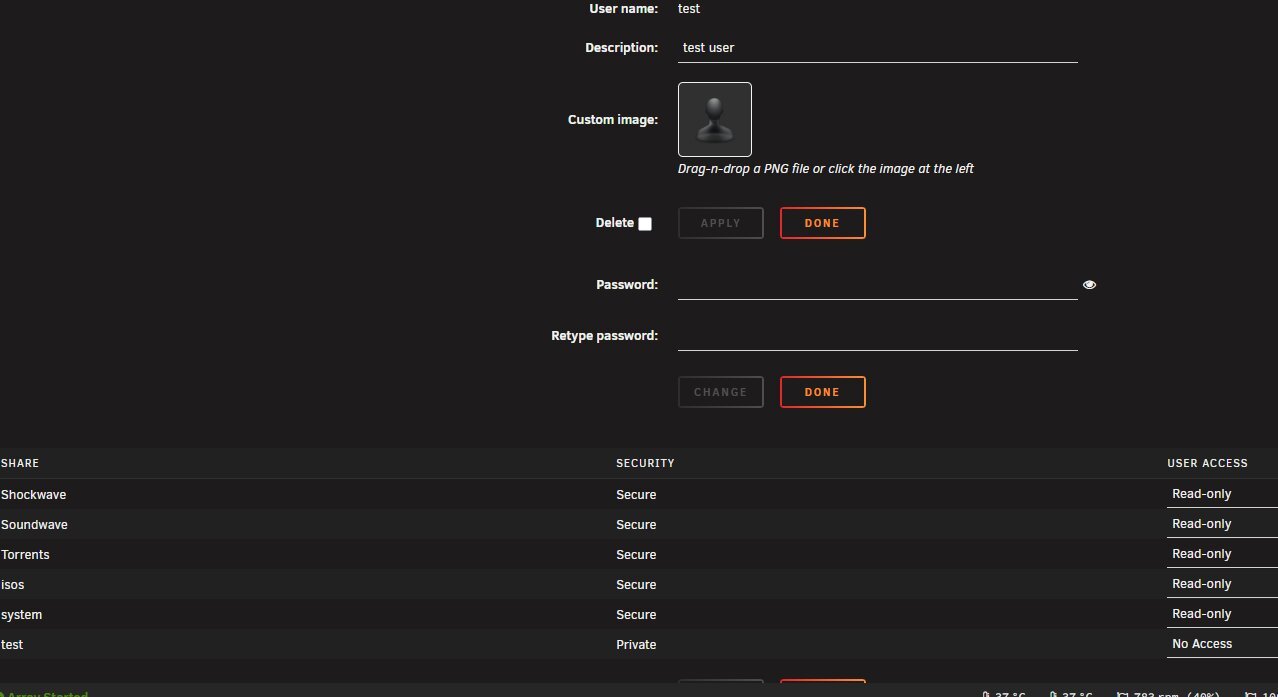

Ok so I created a new user (test) and THAT user has write access to both test and Soundwave (from the Linux laptop I kinda don't trust my Windows install at that point since it tells me something about trying to connect to a shared resource using more than one user is not authorised (or something like that)
But the new user WORKS fine in Linux.
Some screenshots and a new diagnostics file are included.
If it's only a user config hiccup, I guess I could just delete the user and create a new one? Or edit its file? Or restore it from an old flash backup?

This share is 'Private'.
These three shares are 'Secure'. This means that there is read only access via the Samba "Public' permission to them

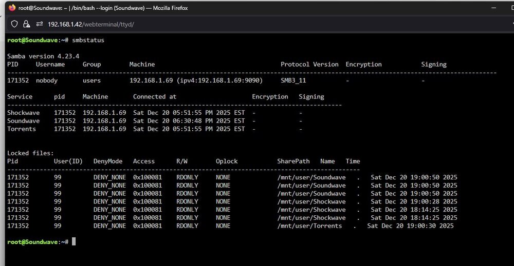

I would be checking to see that you are actually logging onto this server using Share Access users. On Windows 11, setup a Windows credential to do this. (Otherwise, it can be very easy to accidentally gain access the server using a guest account (Public permissions in 'Secure'). The fact that you have no access to the 'test' share supports this presumption since there is no guest access in 'Private'.

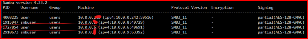

We can verify this if you access the server from your computers and then run this command in the GUI terminal:
smbstatus

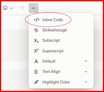

Please capture the output using a screen capture if possible. If you copy-and-paste the text, please formatted the copy as in-line code. See here for how to do this in your reply:

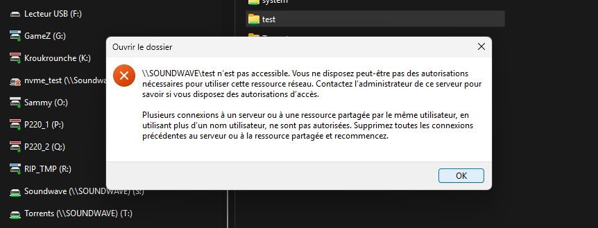

My post above was being written during the time when you posted this post...
Yes, Windows allows only one user from each client computer to log onto each server. (This has been true for many, many years now!) Don't be afraid to permit your 'test' user to have read-write permissions from Windows. The only bad thing that can happen will be done by you. (What the airlines call 'cockpit error'!)

How, I suspect that English is not your first language and I am not sure how well you can comprehend things. I do want to say one thing about Windows networking. IT is difficult to make changes to the windows SMB setup because there is no easy to stop and restart the the SMB service. So my advise is reboot the Windows Computer any time you make a change to the SMB settings.

smbstatus says those shares are readonly. But I can't access those either on the Linux laptop. Anyways, there's the screenshot.

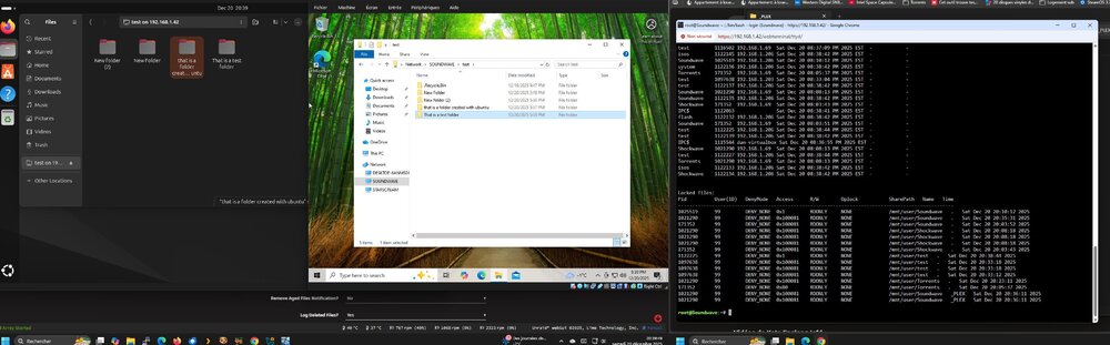

OK, so it seems something's very wrong with both my kubuntu laptop and my win11 machine. in both VMs (ubuntu and win10), it works....
Any idea why it's not on the win11 host?
I deleted the dan user and recreated a new one on the server.
Edited by Hamsterdan71
And creating a new user in Windows (the host) works. But I don't see why it wouldn't work on the linux laptop. I will try something tomorrow using a spare Unraid license.
OK---- Look at the /config/smbpaswd file on your flash drive. (It is a standard text file so any text editor can open it.) Typical below:
The number 1000 for smbuser is the User (ID) in the smbstatus output. That tells you which Unraid Share Access user is accessing the file.
Lets stat here with this part of the output:
I know that the IP address of my Windows 11PRO PC is 10.0.0.6. (I looked it up in Settings on the PC.) This also shows that I an logged as "user". The User (ID) for "user" 1001. And the PID for this login from my PC is 1727854.

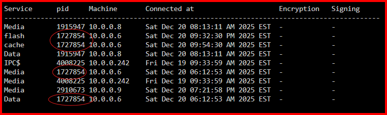

Let's go on:
This section shows the Services that are running. By looking at the pid numbers I can determine what computer is using that service. (Remember that 1727854 is pid for my PC)

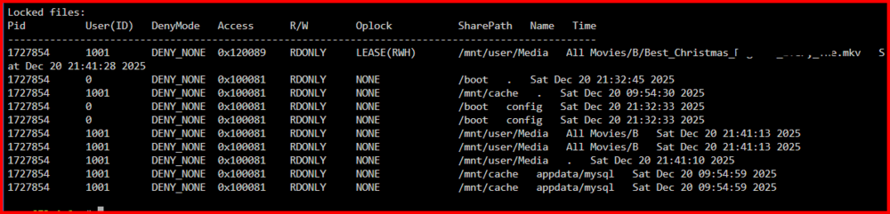

The final section-- "Locked files" is probably the least helpful.
The 'R/W' column is always "RDONLY" in my experience. It also seems to show every connection made since the PC started up. The listings seems to disappear when the PC is actually logged out of the server. (The top line with any actual file listed is the capture when I was actually playing a file.)
Please understand that if you have two or three computers actively using your server, the output from this command output becomes quite busy. (Lots of lines of information to review and figure out what is assigned to which PC.
