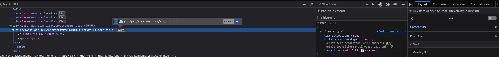

  2. Hello. I have a weird bug. Don't know if it's related to my version (7.4.0 Beta2), but there's a bl;ank space where the icon should be in the header, left to the power button. I've attached a screenshot. And using the white them does not do anything different. clicking on that blank space does nothing. I have also included a screenshot from Firefox's screenshot tool.
  3. Deleted and recreated my user. seems to have fixed it. Will cross fingers.

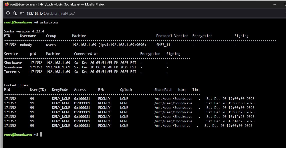

  6. Yes, that's what I did. recreated credentials and remapped drives. but problem is very intermittent. and it happens on all my shares. As for AI, copilot is even worse. it invented unraid preview versions, told me it lied when confronted, and said it made for a nice conversation that looked believable. I can't believe OPCD will use AI for 911 dispatch. guess they haven't watched 9-1-1. Anyhow, thanks. Worse case I reinstall 10 pro. I know it worked without all the slop in 11.
  7. AI thinks (yeah right) it's something with Win11. But i'm probably far from the only one using Win11 home with Unraid. will have to test further under Linux. but I caught something interesting in my system log Aug 9 06:24:09 Soundwave smbd[36948]: chdir_current_service: vfs_ChDir(/mnt/user/Torrents) failed: Permission denied. Current token: uid=1002, gid=100, 4 groups: 100 3003 3004 3006 Aug 9 06:24:09 Soundwave smbd[36948]: [2026/08/09 06:24:09.789043, 0] ../../source3/smbd/smb2_ioctl_network_fs.c:229(fsctl_srv_copychunk_vfs_done) Aug 9 06:24:09 Soundwave smbd[36948]: fsctl_srv_copychunk_vfs_done: copy chunk failed [NT_STATUS_ACCESS_DENIED] chunk [1] of [16] So seems Windows is the culprit. but I am far from a network engineer.

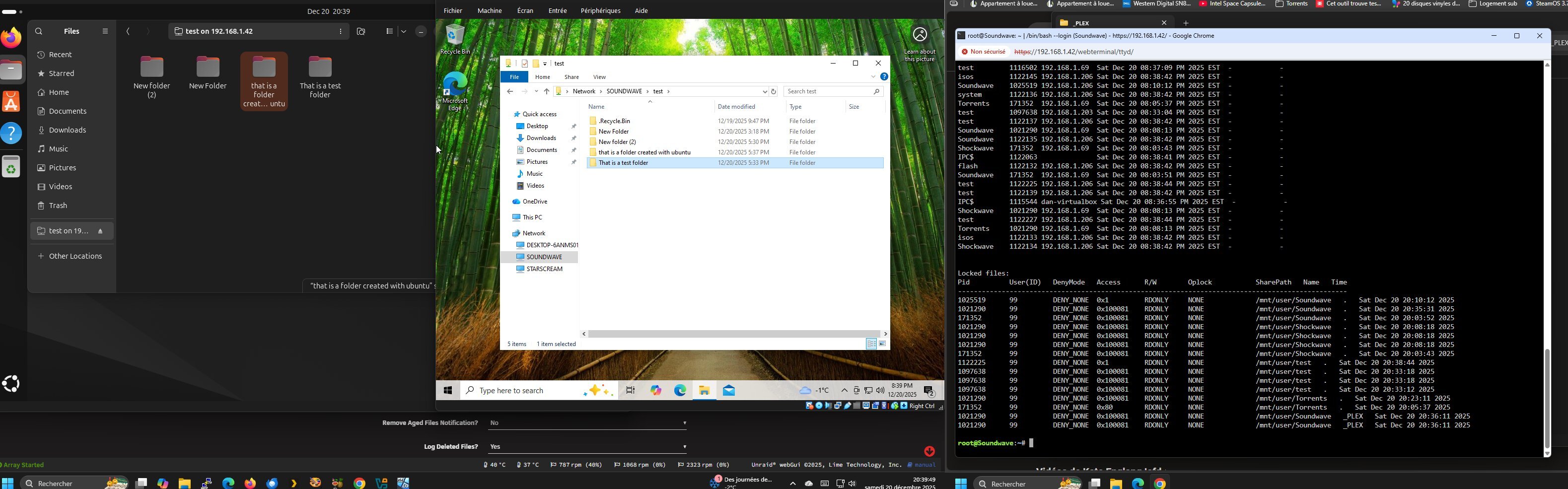

  8. OK. What I found (With Google's AI help) net use * /delete /y klist purge Press the Windows Key, type Credential Manager (or Gestionnaire d'identification if it's in French), and hit enter.Click on Windows Credentials (Informations d'identification Windows).Scroll down to the Windows Credentials section, find any entry matching your Unraid server's name or IP address, click it, and hit Remove (Supprimer). ipconfig /flushdns nbtstat -R netsh int ip reset netsh winsock reset Then full shutdown/reboot. What do you think
  9. And, (recurring problem for at least 2 years, ) every file or folder I move from Windows to Unraid is set with the executable flag. When I reboot, I'll try from Linux. That workstation also has an SSD for Kubuntu LTS. Because running docker safe new perms fixed it drwxrwxrwx+ 1 nobody users 3 Aug 8 21:17 Stuart\ Fails\ to\ save\ the\ uiniverse/ But, drwxrwxrwx+ 1 nobody users 3 Aug 2 14:10 ./ drwxrwxrwx+ 1 nobody users 5 Jul 30 20:55 ../ drwxrwxrwx 1 nobody users 4096 Dec 21 2024 Gundam.Requiem.for.Vengeance.S01.MULTi.1080P.NF.WEB.x264-LiBERTAD/ drwxrwxrwx+ 1 nobody users 10 Jun 27 01:01 P_DANCE_S_EN/ drwxrwxrwx+ 1 nobody users 10 Jul 16 01:28 P_DANCE_S_FR/ drwxrwxrwx 1 nobody users 4096 Oct 24 2024 Terminator.Zero.S01.MULTi.1080p.NF.WEB.DDP.5.1.x264-TFA/ drwxrwxrwx 1 nobody users 4096 Jan 19 2025 The\ Flintstones\ MULTI\ VFF.VFQ/ drwxrwxrwx+ 1 nobody users 5 Aug 8 21:16 _EN/ drwxrwxrwx 1 nobody users 4096 Aug 2 14:08 _FR/ There's stil a + for some directories.
  10. drwxrwxrwx 1 nobody users 203 Aug 28 2025 †††\ -\ Permanent.Radiant\ (2022)/ drwxrwxrwx 1 nobody users 203 Aug 28 2025 †††\ -\ Permanent.Radiant.Remixed\ (2023)/ Those are clean. I was able to move two files tonight. drwxrwxrwx+ 1 nobody users 3 Aug 2 14:10 ./ drwxrwxrwx+ 1 nobody users 5 Jul 30 20:55 ../ drwxrwxrwx 1 nobody users 4096 Dec 21 2024 Gundam.Requiem.for.Vengeance.S01.MULTi.1080P.NF.WEB.x264-LiBERTAD/ drwxrwxrwx+ 1 nobody users 10 Jun 27 01:01 P_DANCE_S_EN/ drwxrwxrwx+ 1 nobody users 10 Jul 16 01:28 P_DANCE_S_FR/ drwxrwxrwx 1 nobody users 4096 Oct 24 2024 Terminator.Zero.S01.MULTi.1080p.NF.WEB.DDP.5.1.x264-TFA/ drwxrwxrwx 1 nobody users 4096 Jan 19 2025 The\ Flintstones\ MULTI\ VFF.VFQ/ drwxrwxrwx+ 1 nobody users 5 Aug 8 21:16 _EN/ drwxrwxrwx 1 nobody users 4096 Aug 2 14:08 _FR/ And I moved those directories unto my _EN folder drwxrwx---+ 1 dan users 3 Aug 8 21:17 Stuart\ Fails\ to\ save\ the\ uiniverse/ And you got it... So It's probably Windows at that point, that's my admin account
  11. Home 25H2. and Yes I use my credentials for the standard user. Problems happen when moving files from the Torrent share to the Plex share. Qbittorrent runs on the Windows machine and then dumps the file onto the Torrent share. And I have np issues with Linux's CLI.
