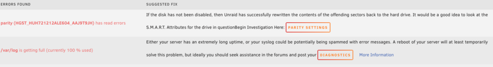

Fix Common Problems says:
Can it be determined if the Parity disk is bad or it is the cabling?

It's not logged as a disk problem, and SMART looks OK, so most likely it's a power/connection issue.
Your other FCP error is your log filling up. Take a look at your syslog and see if you can figure out what other machine on your network is causing all those log entries and see if you can make it stop.
Simplest way to fix your log full problem is to reboot.
