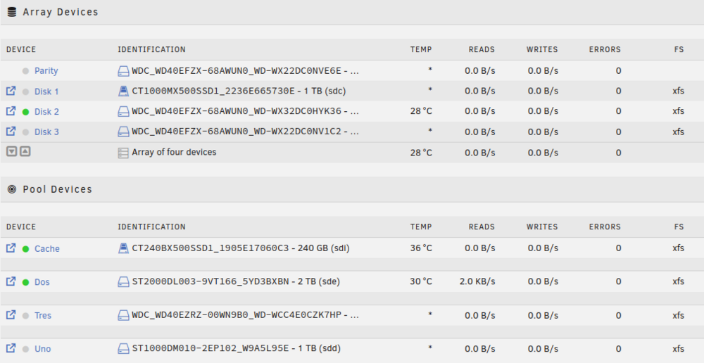

Please post a screenshot of Main with the array started to check the current config
I move files between disks, not between shares. Each file is within its share and is on a single disk.

22 hours ago, Nelo3D said:
I have a series of disks in the pool
So they are not "in the pool" which would mean "all of them in the same pool", they're each in separate pools. So yes you should be able to move them to the array as is.
You need to do a "new config" then add them, and that will then rebuild parity.
Edited by Kilrah
In other words, it is as if I had 4 pools, right?
Thank you so much.
Correct, single device pools can be moved to the array with a new config.
