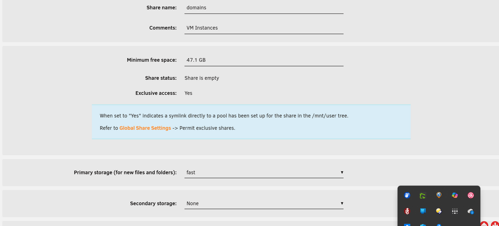

@trurl here are the user share settings for domains:

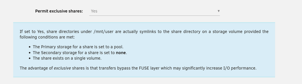

and my global share settings:
It looks like I'd need to Permit Exclusive Shares, and then set that in the domains share settings.
Making that change would apparently require shutting down everything, VMs, Dockers, and the Array.
And the benefit is better VM performance? Is there any downside?
I think I set up the "mover" thinking it would be easy to back up the VMs to the Array, but it turned out that copying a VM .img from newcache to array is incredibly slow. I don't want to leave the VMs shut down that long. But using the magic of btrfs, I can shut down a VM, copy its image file to a folder on newcache (which takes about a second), restart the VM, and let Unraid perform the leisurely copy of the .img file copy to the Array. Once copied to the Arrary, I can then delete the copy from newcache.
As @SimonF informed us
On 1/4/2026 at 5:46 PM, SimonF said:
VMs bypass fuse because at VM start it replaces the file names with the direct disk mapping.
So it doesn't matter.
mover doesn't do backups
Even though fuse is bypassed, there is no good reason to move domains, so Primary:Newcache; Secondary:none
You should make sure none of domains is on the array.
