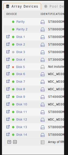

I have a 2 parity drive UNRAID Version 6.12.4 2023-08-31 with 13 data drives.
9 hours ago, daytona235 said:
Can someone please point me to the best practice when using ZFS?
Nothing extra typically needs to be done; you can scrub the disks to confirm all is good, but that should only be needed if there are sync errors after doing a parity check.
so this is wrong.
if all theses 12 disks (2 parity) ... each disk made there own zfs zpool with 1 disk. you lose all the zfs benefits such as rad z mirroring, raidz 1 (equivalent to raid 5 miror and parity stripe)
parity done't fuction as it should when the disk is lost.
usualy you would pare mutiple disk togetr in a zpool 3 disk min to make a raidz1 which strip[es for speed and mirors for redundacny/protection. you can lose 1 disk and still maintain all your data.
or do a raidz2 same strip and mirror, but cand lose 2 disk and keep all your data. (min of 5 disks)
see the zfs docs:
https://docs.unraid.net/unraid-os/advanced-configurations/optimize-storage/zfs-storage/
and a few youtube videos:
https://www.youtube.com/watch?v=XQC6lXOXGT4
https://www.youtube.com/watch?v=UR5RCItyCsw

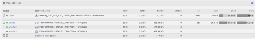

and forum post:
I highly recommend fixing your storage by pulling 3 disk of equivalent size and making a zfs raidz1 reformatting them to make a zfs pool
the hybrid approach ( the setup your currently using)
*The hybrid ZFS-in-array approach is helpful for specific backup or replication scenarios but is not a replacement for a full ZFS pool. ZFS disks in the array are managed individually; you do not get the combined performance, redundancy, or self-healing of a true multi-disk ZFS pool. For full ZFS functionality, always use dedicated ZFS pools.
https://unraid.net/blog/zfs-guide?srsltid=AfmBOor7XJrR8tcD76hGK2pYvWyDKAUcGg1gvI3YkL3jsHH2N01zatXq
