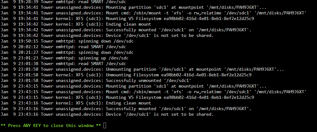

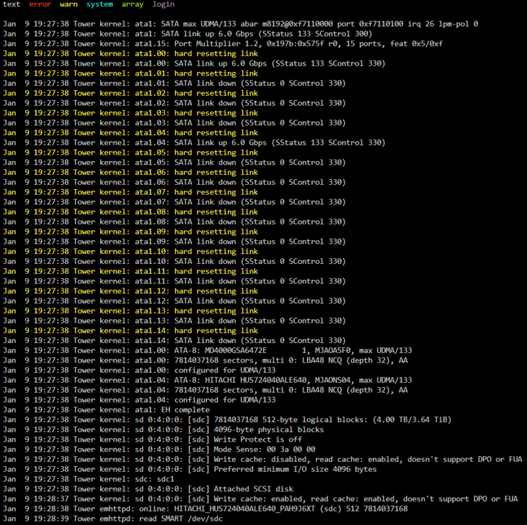

If I mount the drive, the check file system is grey and can't run. Clicking on the Disk Log Information on the mounted drive, the screenshots are the result.
